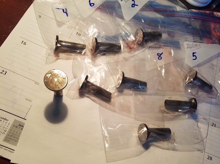

While I was recovering, I contacted an old friend and sent out the #8 lifter (tappet) to him. He programs (C.N.C.) computerized machinery for a large machine shop here in Maine. They have a Rockwell hardness tester. I asked him to check the center of the round flat and the body diameter of the lifter. I can rattle off some numbers, but they won't mean very much. The lifters are hardened, but not as hard as a hand file.
After grinding off roughly .030 off in my milling machine and grinding off another .015 or so with a 4 inch angle grinder.  The round flat of the #8 lifter, measured virtually the same, as the lifter diameter or within one point on the Rockwell "C" scale. In reality we don't know what they are made from, but they are hardened throughout.
I think that is the important thing for us all to know. I asked him to toss the lifter out after he was finished with the test.

This picture was taken before I sent off the lifter for testing. I have since resurfaced the one with the rust.
Steve (in ME)

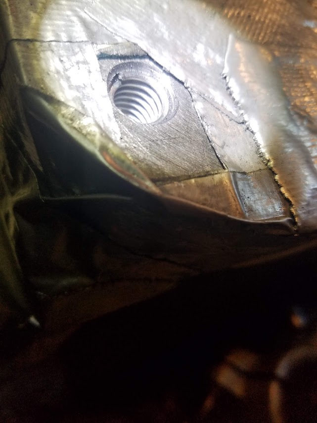

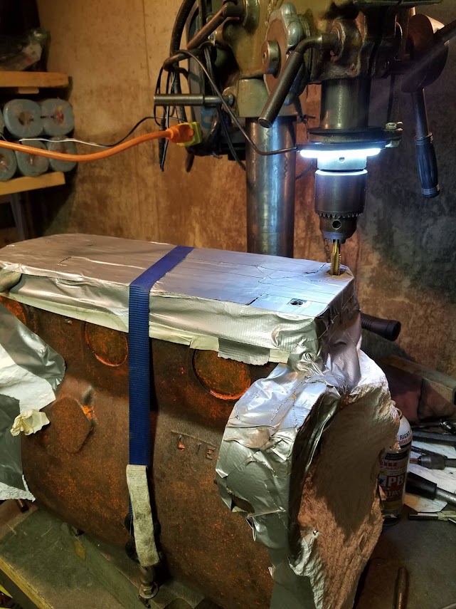

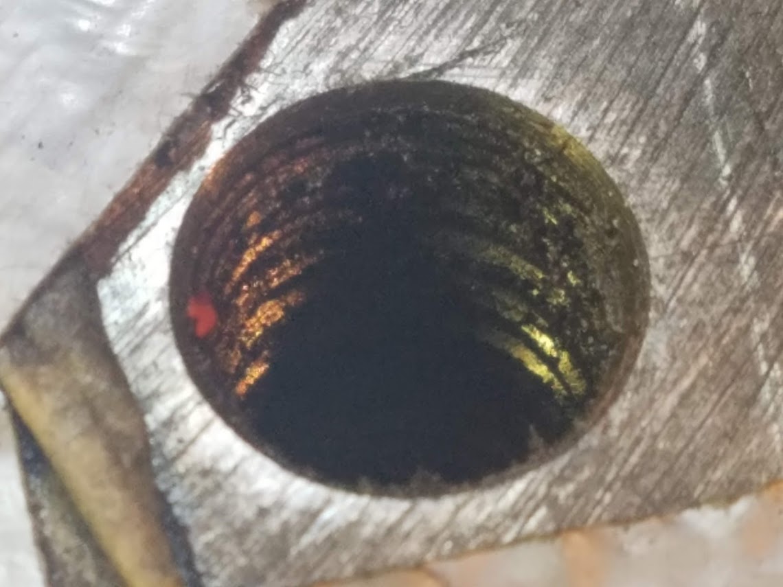

I noticed that I had two stripped out head bolt holes in my engine block. I covered the block the best that I could with duct tape to keep the cast iron chips out of the crank case, and repaired the holes in my drill press with 7/16-14 Heli-coils.
First, I measured to see if the block would fit in my drill press. I strapped down the block onto the base of the drill press, lined up each hole with a regular "on size" 7/16 tap as shown, drilled, tapped, and inserted the coils deep enough, so if the top of the block had to be resurfaced the coils would not interfere.
I am still not an engine re-builder.
My best advice is, if you haven't done this sort of fix with Heli-coils before, don't attempt it. Just to be clear, leave this job to someone that you can trust to do it right the first time.
I can't tell you how many of these I misaligned when I was younger with the shop foreman looking over my shoulder. Confused
Also, pulling the coils out after a misalignment can be a nightmare.
Steve (in ME)
