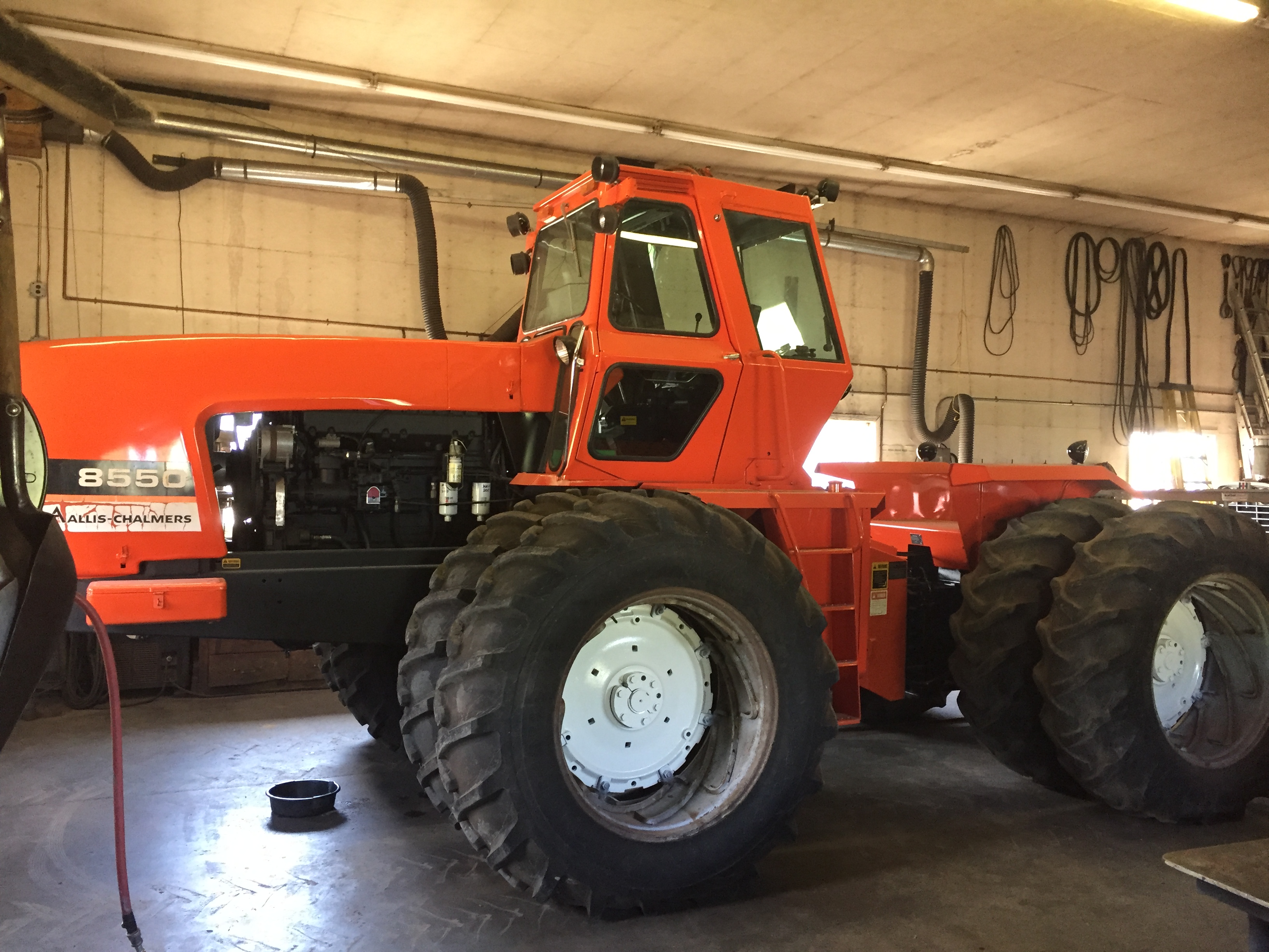

It's been a lot of years since I worked on a water pump for my 8550 but I think I still have a seal kit on the shelf. Those seals are very common or standard should I say. Like either a 5/8" or 3/4" shaft size and the OD is quite common as well. Check with a supplier for electric pressure system pumps that are common and current models.
To some of you guys still running these tractors would you be interested in buying an 8550 that has an 855 Cummins NTC350 in it? Really made a better tractor out of it. Fuel consumption is so much better on the Cummins it will pay for itself in a couple of years compared to the 731. I used to find the 731 burned 12 -14 Imp gal/hr and the 855 doing the same job was 9 - 10. The difference was being out of fuel on the first tankful by 4pm or working till 10pm with the Cummins. Also with the Cummins there is no issue getting parts. We went through the tractor in our farm shop last winter and fixed all the little things like lights, new A/C compressor, and a couple of oil leaks and did a major paint job on the old girl. Looks like new and actually runs like that too. It is a very reliable tractor. I have retired and just want to see it go to a good home. I bought this tractor in 1986 and I have spent a lot of time in my farming life with this tractor.

Sorry! Having trouble posting some pictures of my 8550 that I would like to sell. If any of you guys want pics or more info PM me your email address and I will send you what you want.
