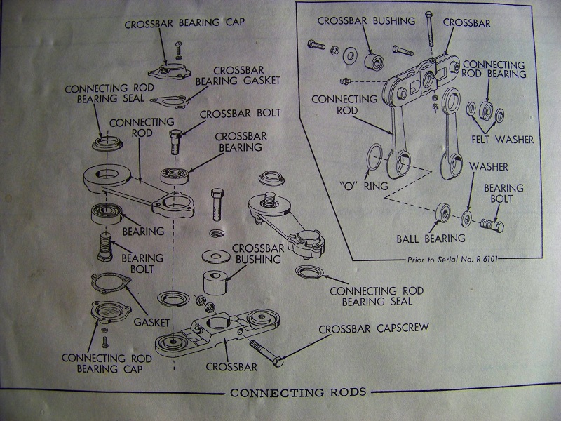

Have you tried to tighten the crossbar capsrew? Maybe this pic. will help.

Flint23 -- Yes, I have tried tightening the crossbar capscrew but it won't tighten enough to take the slope out between the crossbar and the bushing. I'll take it off the mower later to see if there is something in there preventing it from going tighter.
