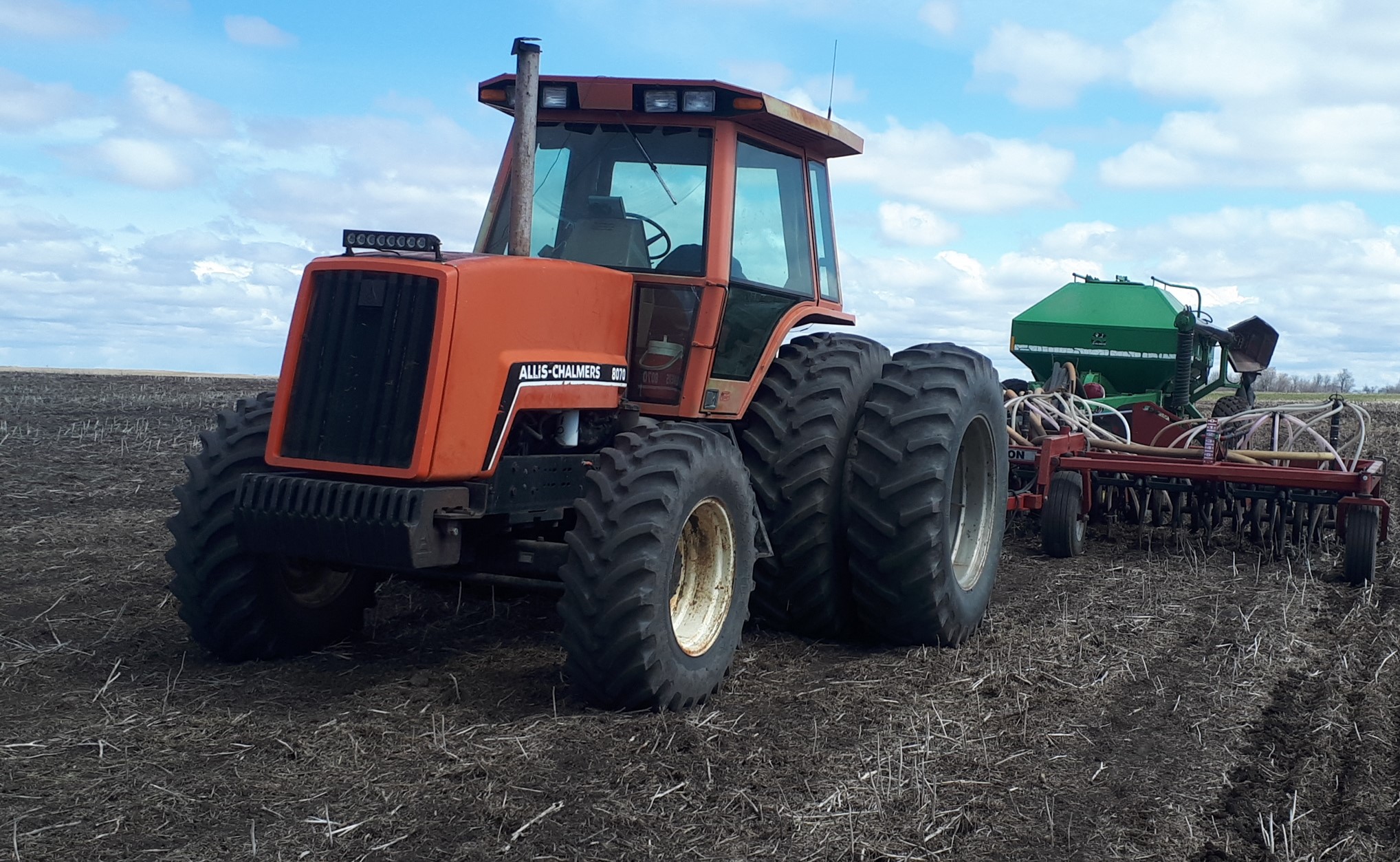

8070 PD transmission temp sensor false alarm.  Light is on all the time including when tranny is cold at startup.   Got new one from AGCO.  Old sensor has one green wire running to it.  New one has two tabs for wires.  One marked G and the other with an R.    Is there supposed to be two wires attached to this?   Can only find one green wire.   The other wire in the harness goes to the hydraulic restriction sensor.  Another question: Is the cap on the hydraulic fill tube supposed to be venting.  I can't find a vent anywhere for either the hydraulic reservoir or the transmission.  My main use of tractor is seeding where it powers hydraulic powered fan.   The hydraulic restriction comes on them goes out after a while.
