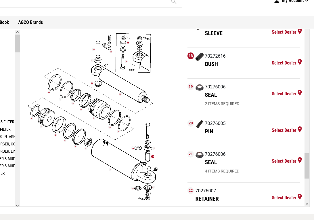

I am getting the power steering cylinder by my local shop - the piston has several scratches in it.  Also need to put new balls and sockets in it.
Looking at the parts book, items 19 an 21 both have the same part number (70276006) although they look different.  Probably a typo, but can someone give the correct part numbers and how many are needed?
Many thanks!

70272615 is the correct # for 19
Unfortunately no dealer has in stock - it is NLA - no aftermarket. It is a spacer.

Thanks tbran, do you have any dimensions of the spacer?  Maybe I can get my fab shop to make a few up.

Series4 that # 19 ID is the same as # 18 bushing, OD is 1>620", thinkness is 0.170" may be wore a wee bit, that shim-washer is tapered on one side maybe for ese of installation
