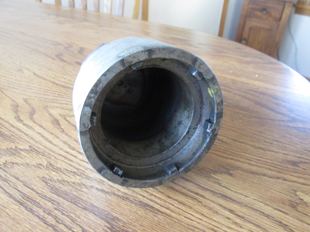

Post Options Post Options   Thanks (0) Thanks(0)   Quote Lynn Marshall Quote  Post ReplyReply Direct Link To This Post Posted: 05 Feb 2017 at 10:11am
I had this tool made. It's well built.

Post Options Post Options   Thanks (0) Thanks(0)   Quote lentsch Quote  Post ReplyReply Direct Link To This Post Posted: 05 Feb 2017 at 11:07am
Lynn- that looks like it would be heavy duty! Do you know where that hole in the hollow shaft has to be positioned? I forgot to mark that when I took the 12 bolts out.

Post Options Post Options   Thanks (0) Thanks(0)   Quote lentsch Quote  Post ReplyReply Direct Link To This Post Posted: 06 Feb 2017 at 6:07pm
Thanks, after closer examination it looks like it was probably about 9 or 10 o'clock. Will your socket work with the shaft poking through? Mine will only work with the shaft removed. May have to do a little remodeling to make it work better!

Post Options Post Options   Thanks (0) Thanks(0)   Quote DougG Quote  Post ReplyReply Direct Link To This Post Posted: 06 Feb 2017 at 7:21pm
Almost looks like a socket for  hub nut for a 4 whl drive truck,,,,

Post Options Post Options   Thanks (0) Thanks(0)   Quote lentsch Quote  Post ReplyReply Direct Link To This Post Posted: 06 Feb 2017 at 8:22pm
The OTC #1931 is for a 1997 to ??? Chev pickup I believe. Sorry no picture yet.
