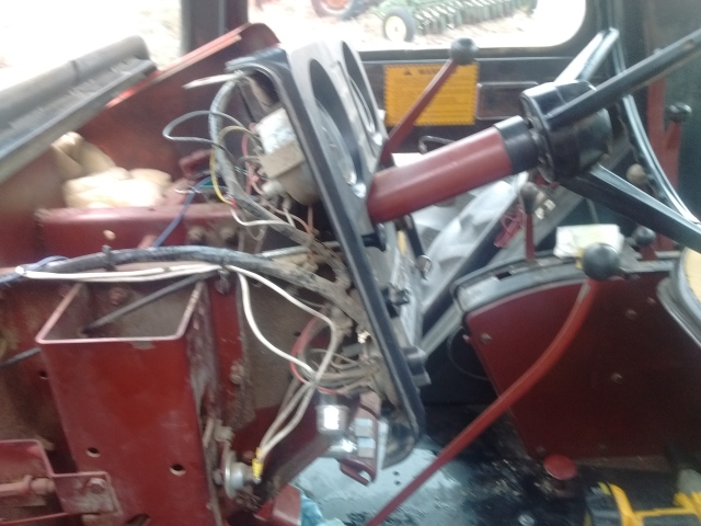

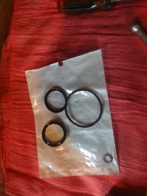

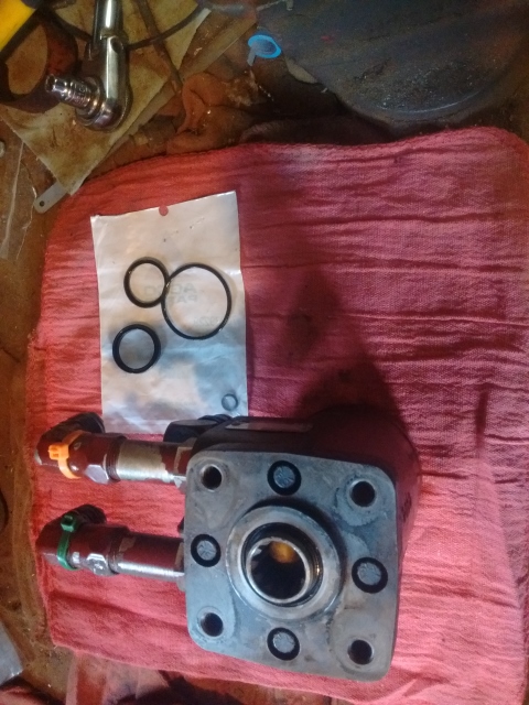

I got it done..no leaks so far...Ron I jus got some pics of a torn up tractor.....its really just nuts and bolts,,,just as the I-T manual says...its self evident....

DR. and t-bran... yea, I already knew not to go any further than just to fix the leak,,just the one small o-ring left,,,I did not see where it went,,hope I didn't F something up by not replacing it too
I ran the tractor for about 30 minutes,,,so far, no leaks...

wow...you did tear a lot apart to gits to it!

I've never had to take that much tin work off any of my tractors, where does that motor sit? then again, none of mine leak....yet.

Yea, I prolly went a little far on sheet metal removal,,I think I didn't hafta take off the top left panel. Jus the top and bottom ones, the most difficult was the 4 bolts that hold the orbit gear to the steering column,,,add some authuritis in,,well let's just say my fingers, wrists, and shoulder letting me know about it now.. Where did I hide the Aleve....
