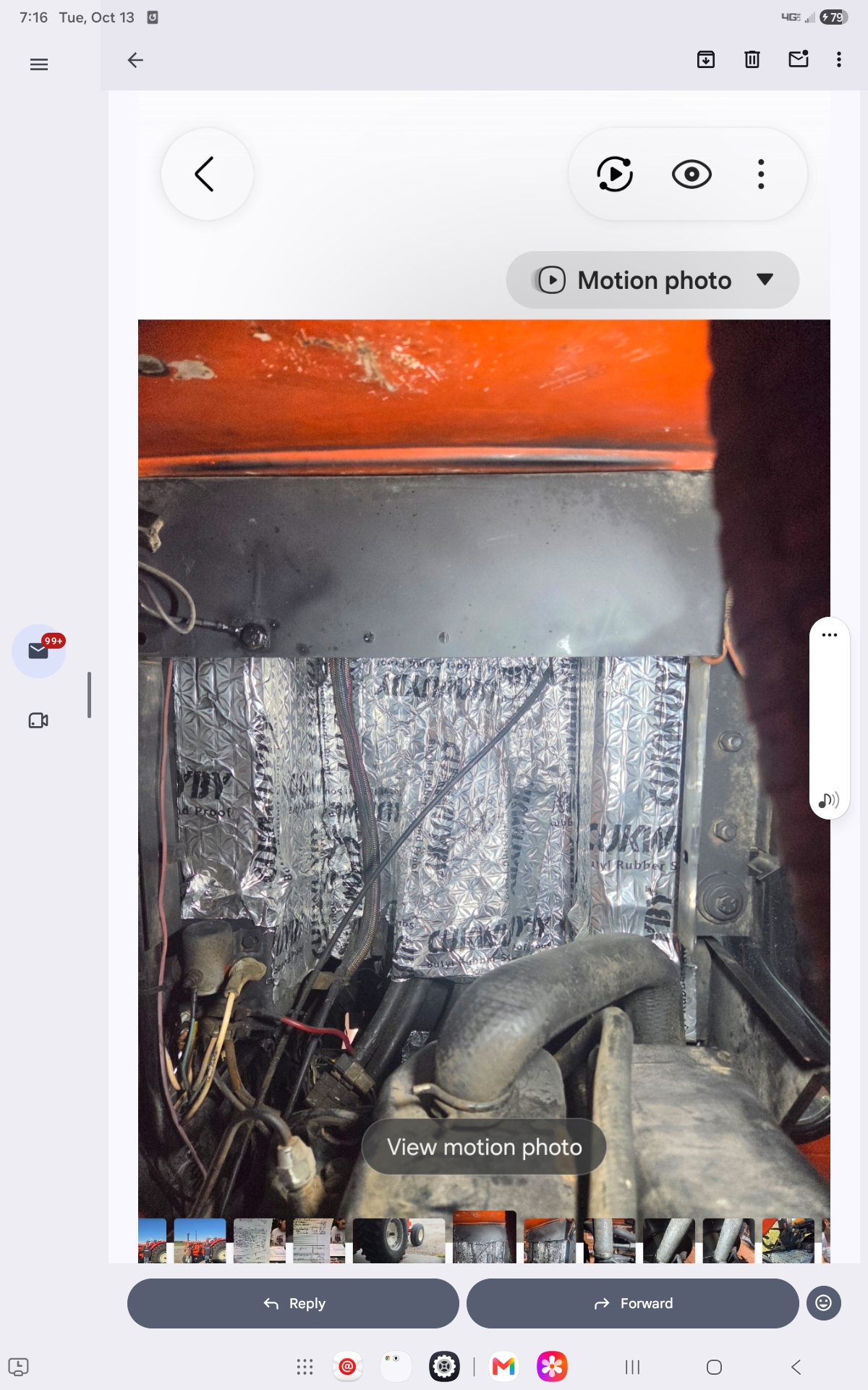

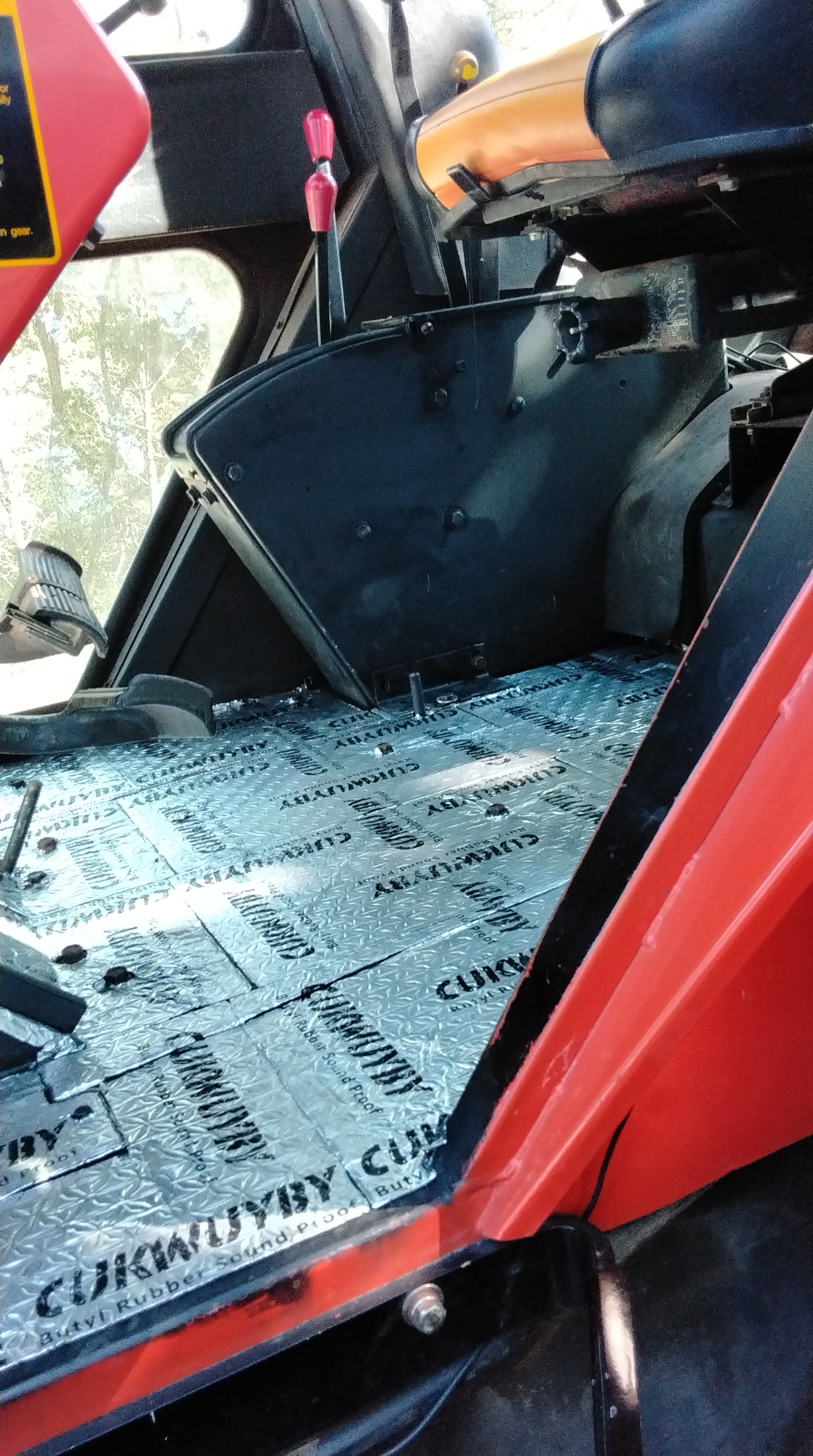

Have had the cab floor out going after leaks. When I pulled the mat there was a piece of angle laying by the console unhooked under the mat. Bolt holes line up, only one in console has threads and one on floor. Saw a Pic of a ragged out 7060 that had that angle on top of the mat with one bolt into console and one into the floor, looks only as a matt holder,is that correct?
Also obviously that console side cover has got to come off to get to the cable ends. How scary of a project is it to open that up?

Angle iron at the front corner ?? bolts to the floor to stabilize the console assembly. That was added when they went to the "T"-shifter for the Power Director and even tho it may be a Power Shift, still had that brace. It isn't for the floor mat.

Top or under the mat?
68 D21 81 7060
Points: 23527
Post Options Post Options   Thanks (0) Thanks(0)   Quote DrAllis Quote  Post ReplyReply Direct Link To This Post Posted: 1 hour 3 minutes ago at 7:52am
UNDER ...directly to the cab floor for a brace/support.
