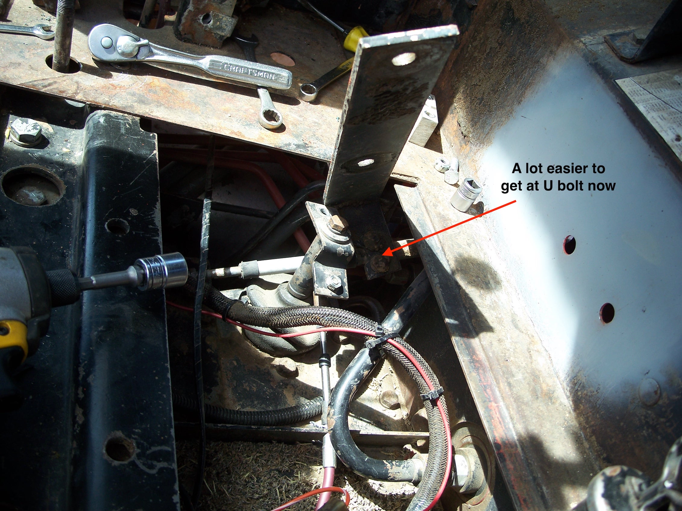

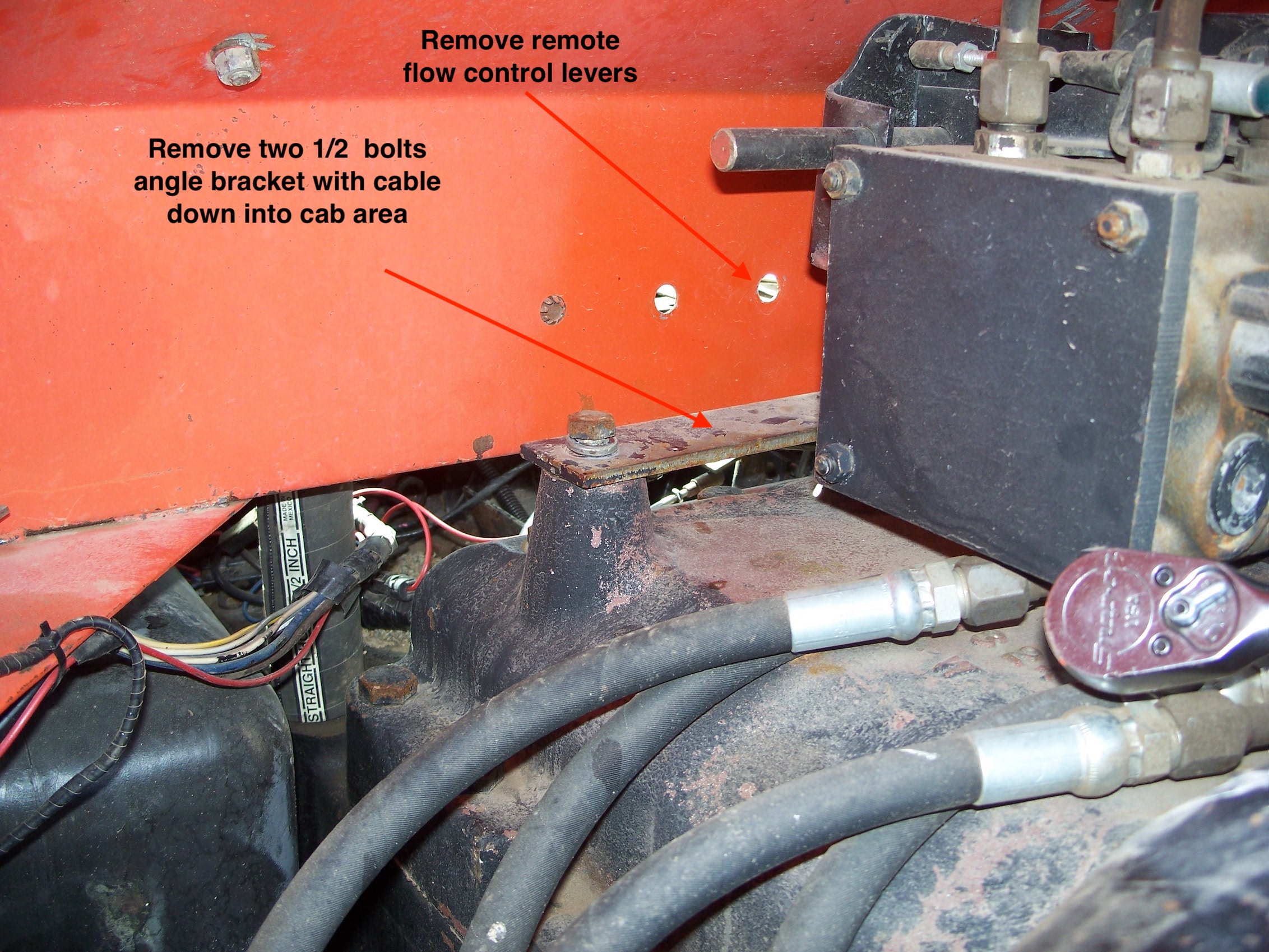

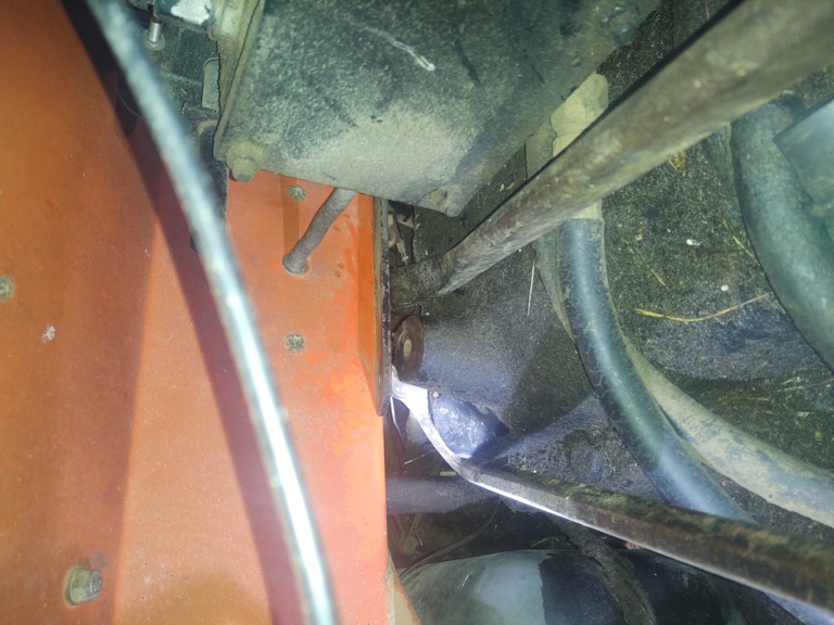

Post Options Post Options   Thanks (0) Thanks(0)   Quote LB0442 Quote  Post ReplyReply Direct Link To This Post Posted: 06 Nov 2020 at 7:14pm
Here is how I did the last one I had.  Took more pictures than this but this might be what you are talking about.
This one has fairly new cab mounts on it so that might have helped.

Post Options Post Options   Thanks (0) Thanks(0)   Quote plummerscarin Quote  Post ReplyReply Direct Link To This Post Posted: 06 Nov 2020 at 7:25pm
Good picture LB. A lot cleaner than mine. I put a smaller wrench on the bracket to slightly twist to get it to clear the mount boss and slide forward to reach through the cab floor Hope that makes sense to you. But as Doc has said be careful not to twist too much and put a permanent kink in it.

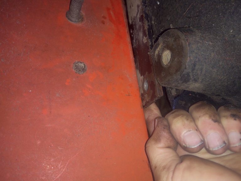

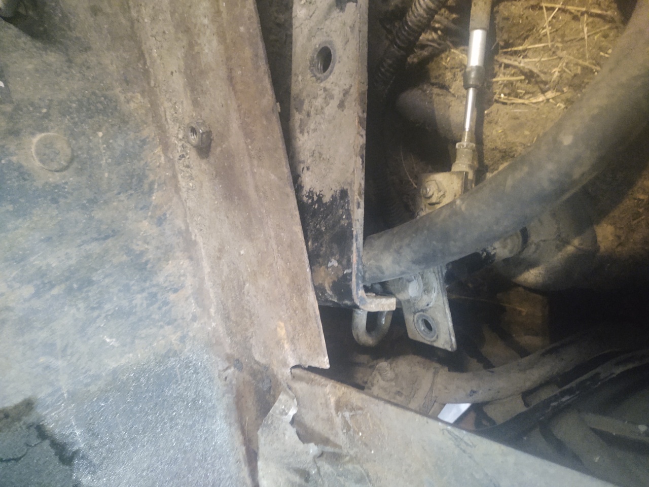

Post Options Post Options   Thanks (0) Thanks(0)   Quote calico190xt68 Quote  Post ReplyReply Direct Link To This Post Posted: 07 Nov 2020 at 7:44am
Good news is that I got it!  After my last post, I went back out to stare at and try to figure something out, so I didn't see the above posts until this morning.  The big revelation is that you have to position that anchor plate against the bottom of the cab as flat as you can and then push forward.  I actually didn't figure this out on purpose.  A friend who hunts my property got done with his hunt and saw me in the barn and decided to jump in and help.  He worked the back of the tractor and I stayed in the cab.  I had actually snaked a medium sized ratchet with 1/2 inch socket into that space and loosened the nuts on the cable two clicks at a time, thinking that the anchor plate was as far forward as possible.  It was not.  As I was having my friend reposition the cable to get the socket on the nut, he pushed it into the cab by accident.  I don't know how he did it, nor does he.  When it suddenly appeared, I couldn't believe it.
I am kind of glad I didn't see the post on jacking the cab up because I probably would have done it. :-)
I want to point out to others that the u bolt has to be taken completely out.  I thought I could loosen it and pull the cable out the back, but it fits too tight in the metal slot on the cable to do that.
I cannot thank everyone enough for the posts and hope my details helps the next guy.  Sounds like others have struggled as well.  Couldn't have done this without the forum.
Now I wonder if putting it back together will be easy?  I can't tell for sure if there is a front or back to the Bunker Hill cable.  There is a slight difference in length of the metal ends but not a lot.  I don't want to put it in backwards and have to redo it.
See my pics.

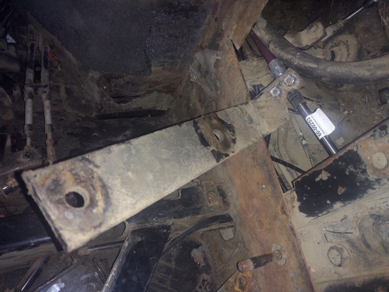

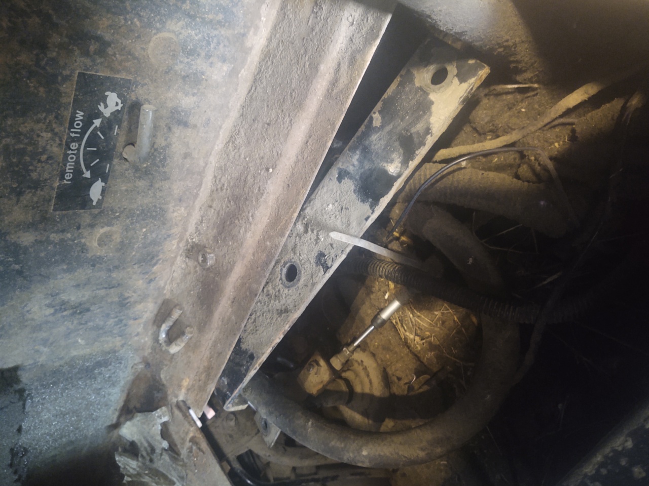

Post Options Post Options   Thanks (0) Thanks(0)   Quote calico190xt68 Quote  Post ReplyReply Direct Link To This Post Posted: 07 Nov 2020 at 9:42am
Since I got the anchor plate in the cab without the  half moon slots, I decided to try and get it back out without them.  Admittedly, it is a better way to prevent screwing up the cable.  I replaced he original nuts with the nylon locking nuts,  I rotated it down and slid it under the cab.  It got caught between the cab and the cast iron mounting pads for the anchor plate.  That's what the half moon cuts resolve.  It seemed it only lacks about 1/4 inch.  So, I put a pry bar on the inside pulling it toward me and a pry bar underneath to push up.  It didn't take a lot of effort and the plate popped up and out on the end you can see.  can't do it with your hand though.  I then pushed up on the end I could see with a pry bar and it popped up and over the mounting pad you can't see.  I don't think I hurt anything and I didn't use a lot of pressure.  If I had, I was going to stop.  After that it was just putting the ends on, threading the other end of the cable into the cab and console and reconnecting.
The only thing I see as slightly wrong, is that the shifter doesn't bottom out on lo setting.  It stops about 1/2 inch from bottom.  High range goes all of the way up and stays.  I am guessing I need to extend the ends of he cable in the console as a starting point.  Maybe that would give it more room to bottom out?  Could be the end in the floor too.  Did anyone else have to make adjustments like that?  This job seems to be almost done!  What a pain in the butt but still better than de-installing the cab
Hope this helps someone else when they dive into this job.  Tried to document it well.
Here are some pics of what I did.
