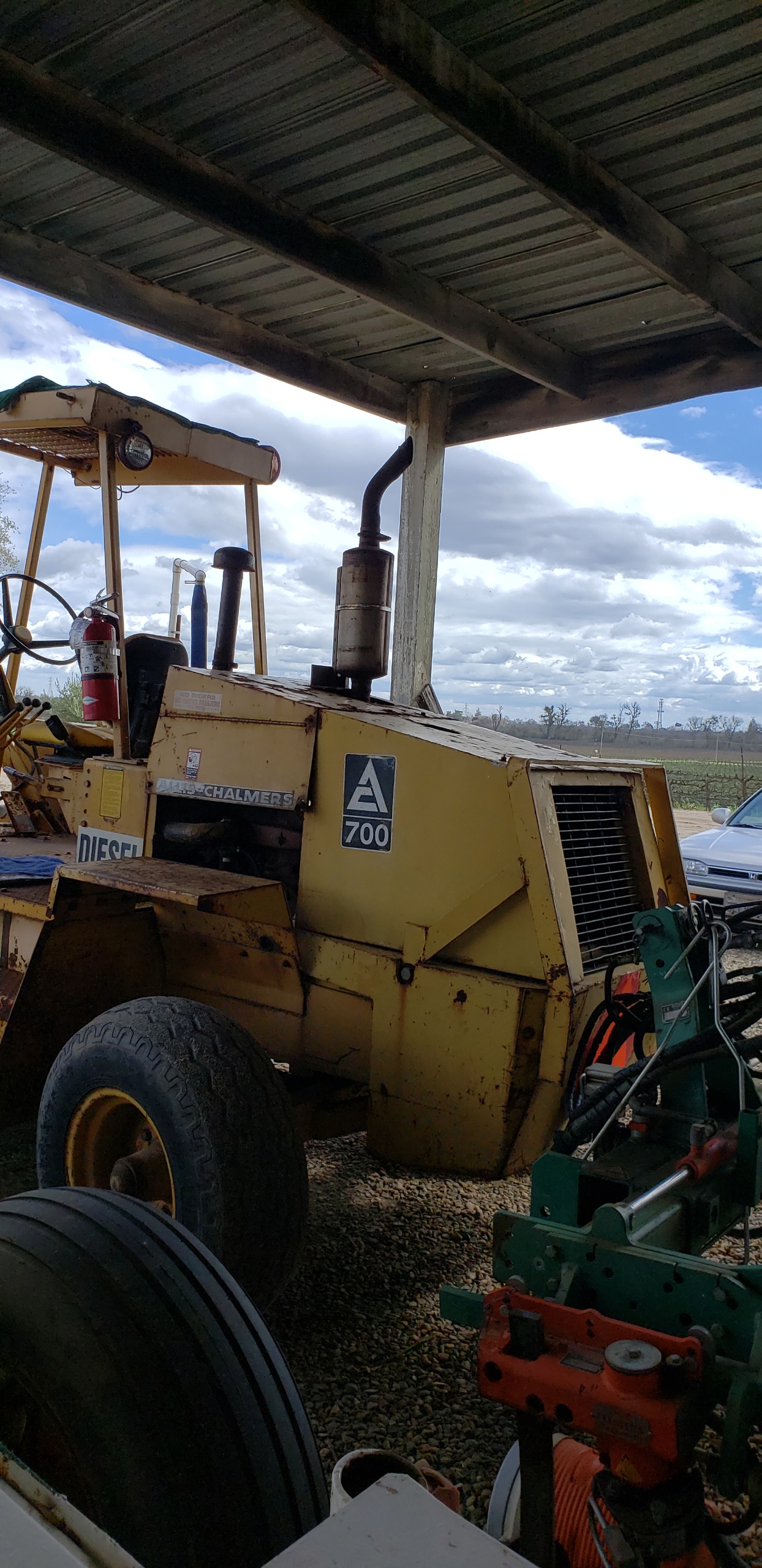

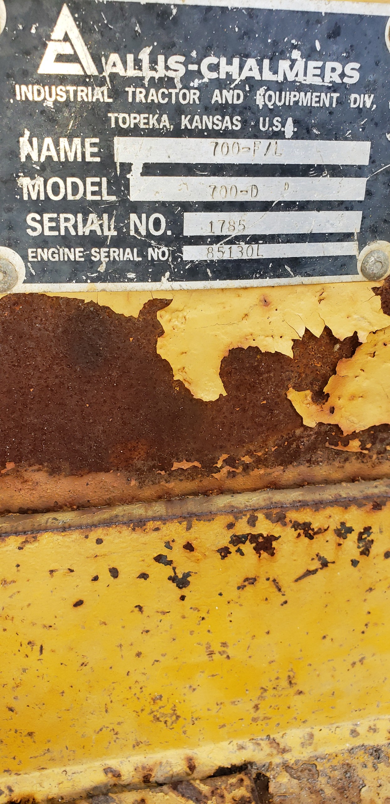

those are two of the pictures i was sent by the customer. none of the actual engine. I can go get some but it wont be til next week.
Points: 22091
Post Options Post Options   Thanks (0) Thanks(0)   Quote DrAllis Quote  Post ReplyReply Direct Link To This Post Posted: 06 Mar 2020 at 11:13am
That should be a Perkins engine. That isn't the newest (and last) "D"-series that were turbo diesel only. It's an older version and is a "D" designation because it's a diesel not a gas engine.
