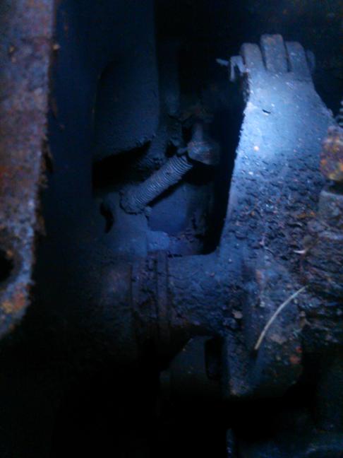

Post Options Post Options   Thanks (0) Thanks(0)   Quote scooter01922 Quote  Post ReplyReply Direct Link To This Post Posted: 16 Jul 2015 at 6:41pm
So theres the front as it sits, i see the spring but not how the heck it would do anything.

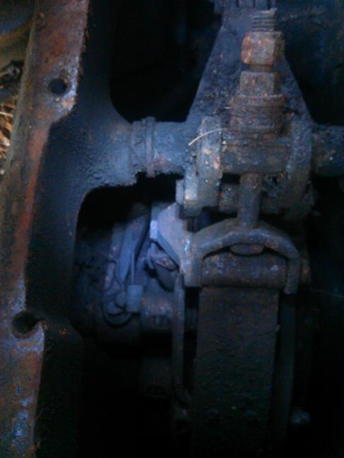

Post Options Post Options   Thanks (0) Thanks(0)   Quote scooter01922 Quote  Post ReplyReply Direct Link To This Post Posted: 16 Jul 2015 at 6:43pm
Theres the actual release bearing end. I pried around with a crowbar and nothing moves at all. Its a little crusty in there but the cover was well installed and there was no visible moisture when i opened it. Not sure how the heck its so stuck, but then again can't see how it should work either.

Post Options Post Options   Thanks (0) Thanks(0)   Quote scooter01922 Quote  Post ReplyReply Direct Link To This Post Posted: 16 Jul 2015 at 6:44pm
Sorry the pics are so dark, the dozer is located off the grid so i can't just grab a  shop  light and brighten things up, its flashlight or no light.

Post Options Post Options   Thanks (0) Thanks(0)   Quote Randaleky Quote  Post ReplyReply Direct Link To This Post Posted: 16 Jul 2015 at 7:49pm
THE RIGHT STEERING CLUTCH IS SUPPOSED TO RELEASE THE CLUTCHES SO  THE CLUTCHES ARE NOT ENGAGED. I WOULD MAKE SURE THE TRANSMISSION IS OUT OF GEAR FIRST. THEN MAKE SURE THE PARKING BRAKE IS NOT LOCKED DOWN. THAT WOULD BE THE LEVER AT THE SEAT FRAME ON RIGHT SIDE, IT SHOULD BE BACK AGAINST THE SEAT. TAKE A PRY BAR WITH THE CLUTCH LEVER PULLED BACK AND SEE IF ANYTHING MOVES. YOU CAN PUT THE SHARP END BETWEEN THE SPRING ENCLOSED FINGERS TO GET SOME LEVERAGE. DON'T PRY TOO HARD THOUGH. REMEMBER THE AXLE WILL STILL BE ENGAGED FROM THE TRANNY TO THE CLUTCH PACK AND IF THE LEVER PULL BACK DOES NOT RELEASE THE CLUTCHES THE PRESSURE OF THE BAR IS ALSO APPLIED TO THE TRACKS. MIGHT WANT TO SPRAY SOME WD 40 TO LOOSED UP THE METAL PARTS ALSO. WATCH ABOUT SPRAYING ON THE BRAKE BAND PADS AND SURFACE WHERE BRAKE PADS WOULD CONTACT.  RANDAL
