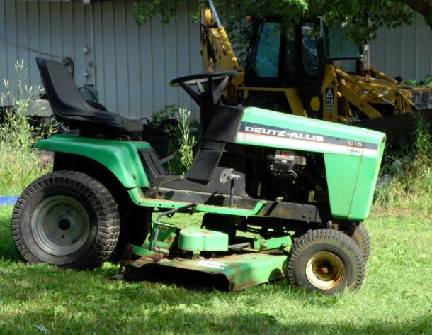

Post Options Post Options   Thanks (0) Thanks(0)   Quote Coke-in-MN Quote  Post ReplyReply Direct Link To This Post Posted: 04 Jun 2012 at 10:54pm
Here is a 616 I put a 18 HP Briggs into , it's in Texas right now and might be coming back this way as Friend i sold it to just bought a new Huskavarna mower . Said he was having trouble with the hydrostatic drive ???  So as he still owes me some cash I am willing to sell it ..
