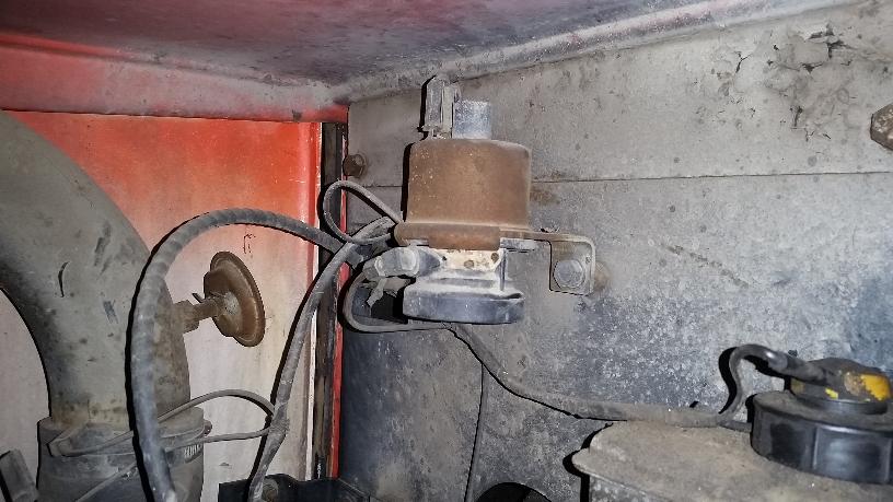

Can someone elaborate on this at all?  It looks like my cap has its own separate little cap, but it doesnt fit on snugly.  Is it broken?  I includedsome picture for reference.  Thank you.
Also, can someone tell me if this is the ether injection unit?  It looks like it is when i compare it to the agco parts book pictures.  I'm missing some parts though if it is.  Could I get some advice on how to get it back operational?

I can't help you on your brakes, but I can say that you do have the ether injector.  However it is missing the can of either.  I think it will accept most cans of starting fluid.
Personally, I would much rather use the manifold heater.  I try to avoid using ether where possible.  If you have the heater, I would recommend it.  If you do not have it, I have a brand new kit from AGCO that will fit right on your tractor.

You're missing the side straps and bottom adjustment device that tightens the can of ether up into the head. I just put a new can of ether into my 6080 and it looked like every other ether kit. Didn't take the side straps off, just pivoted them back and changed cans, pulled the straps back under the new can and tightened it back up. There is a foam-type seal where the can fits up to the head and it can fall out sometimes.

I do have the manifold heater. I read it should be held for 45 seconds before starting so I need to give it some more time in this 20 degree weather we have been having. I appreciate it.

LB, thanks again for the pics they really are worth 1000 words.  I tried to order a new cap from my AGCO dealer, it was $60 so i said no thanks.  I was able to get mine in decent working shape.  It at least will not allow any crud to get in the reservoir.  It looks like good clean hydraulic fluid in there with a good level, so i'm not going to touch it.
As far as the little things go, I will get there eventually.  The AGCO dealer was not able to get me the ether bale, so i have found a used one.  LB how often do you find yourself giving it ether to start?  Do you just give the button a quick poke once its turning over and throwing out smoke?  At what temps do you need to?
I will be investigating the air cleaner next.  I don't have the precleaner, but I pulled off the primary air filter and it was missing the fine particle secondary air filter.  I have that on order now.  I'll get the sensor hooked back up and once i have the proper filters in place, we'll see if the light goes out.  How common is it that the sensor fails?  Why would someone unplug the leads?
