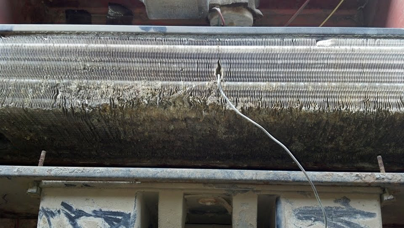

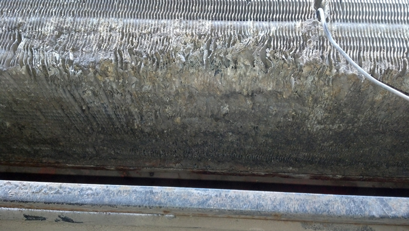

I took off the top of the cab to replace a relay switch.  I notice the A/C fins were disintegrating. Not sure what would cause this to happen.  We have never used the A/C. See Pictures below.  Does this mean its time to replace?  Where would I find the part?

Never seen that before. Salvage yards like Worthing AG Parts would be a good place to start.

dry fertilizer contamination.

I just got down taking mine out & making a new pan for under that,rusted out & water on me all the time.Mine was deterated,took it to Agco dealer he said not available,if it was it would cost $1500.00 I put it back in.

Could you not have it recored??

Do you have a lot of salt in your soil? or alkali?
That's what eating the fins.
