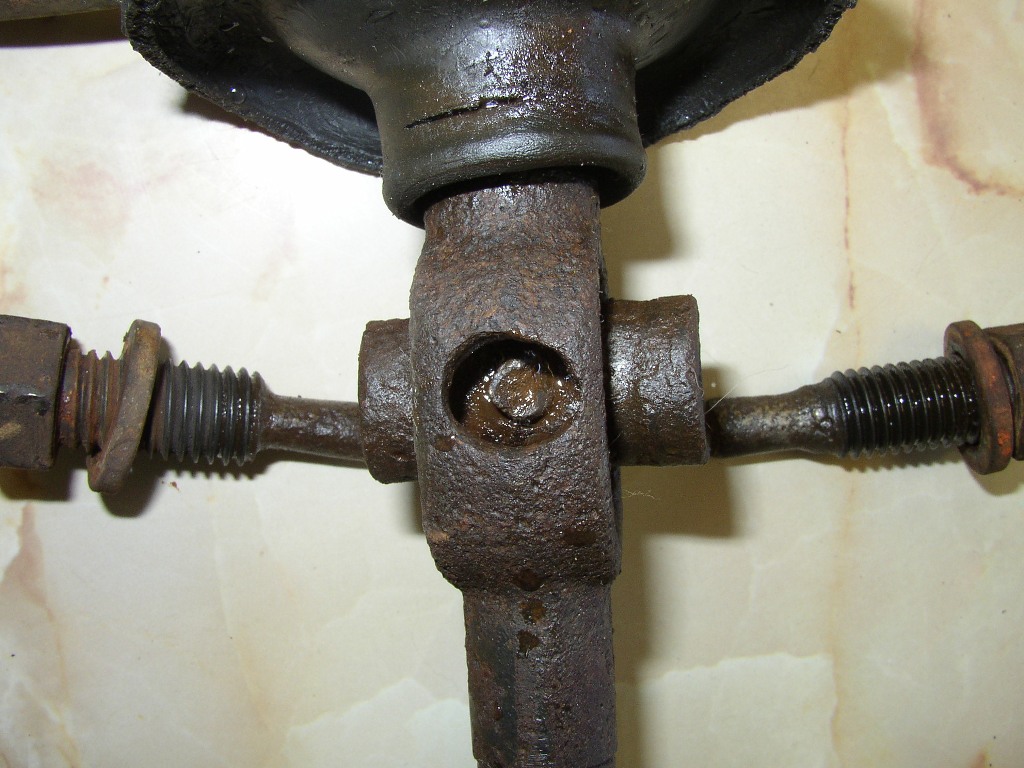

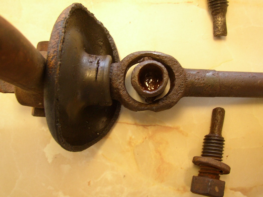

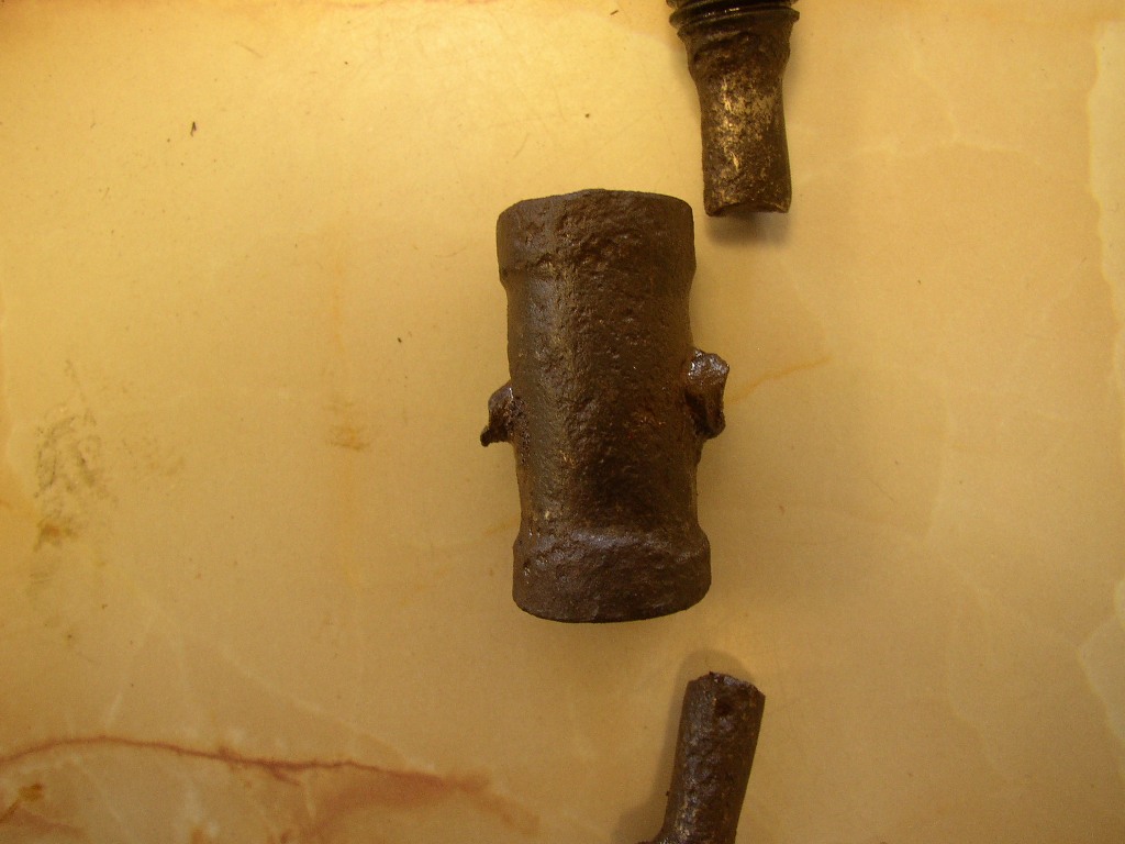

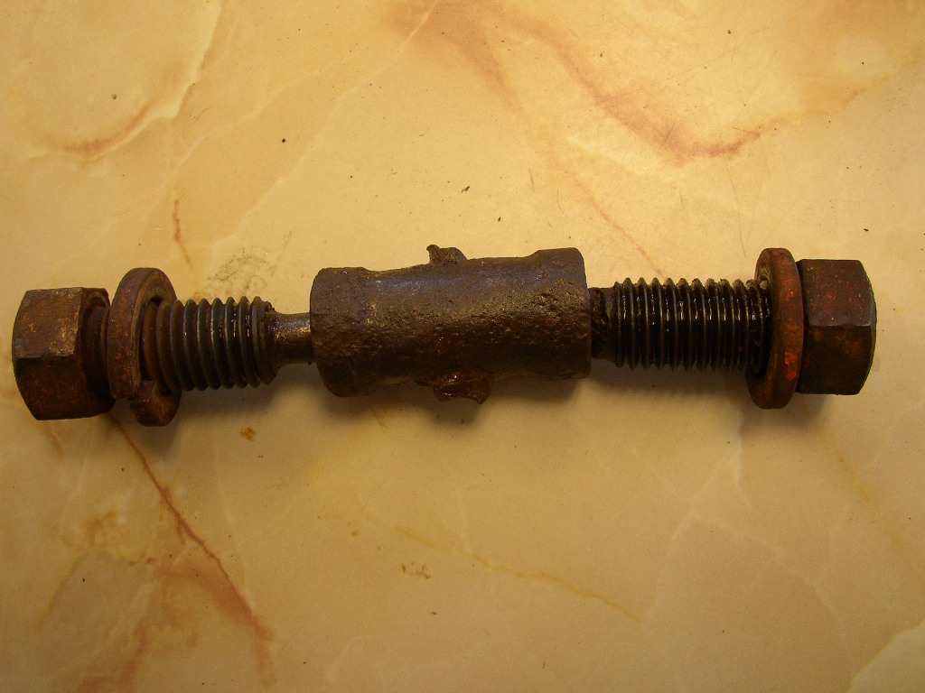

Here's some pictures of one that is worn out. It did still work though. Kind of like a big loose screw driver in there, if you know where to feel for the right shifting for you could still make it work. Coke has explained it so well I thought some pictures might be helpful

Time to find a friend with a welder, lathe and mill. That can be refitted with a little time and effort.

Have did 4 of them so far, some lathe work to make new bolts, drill stock for that center shaft for bolt ends to fit into. Drill hole through shaft for oversize pin , grind flats into each side of pin for end of bolt to hold pin steady . Then build up ball end of the shifter.
Works slicker than snot on a doorknob when done.

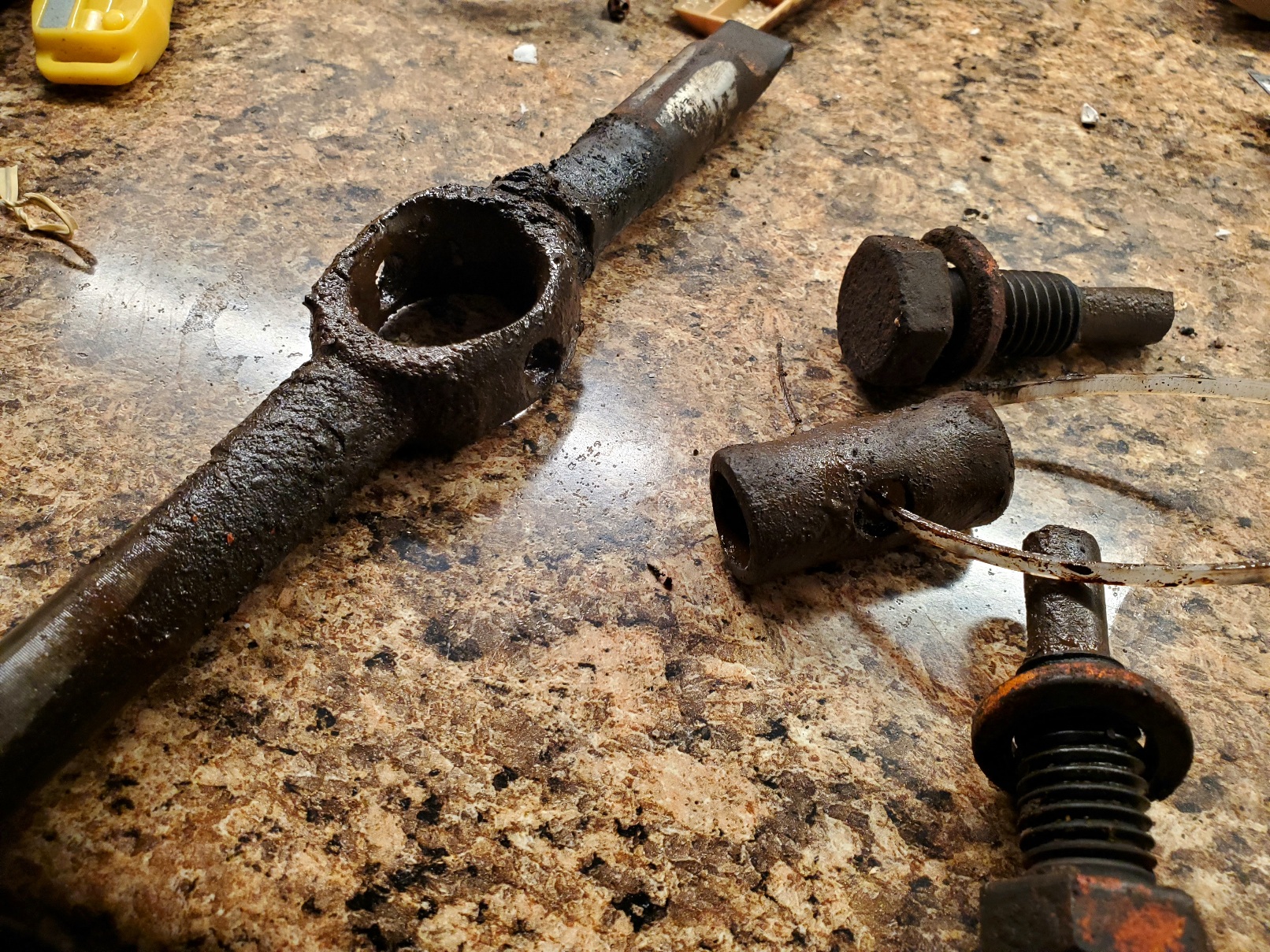

This is whatni gotz....the pin went bye bye! I'm guessing it lives down in the bottom somewhere ?

So when I fixed mine I welded the holes solid on the side and redrilled just larger than the roll pin. I used a roll pin in the center and drilled the center hole Small enough to hold it. Have not had an issue. Done it to 3 so far and all working good.
