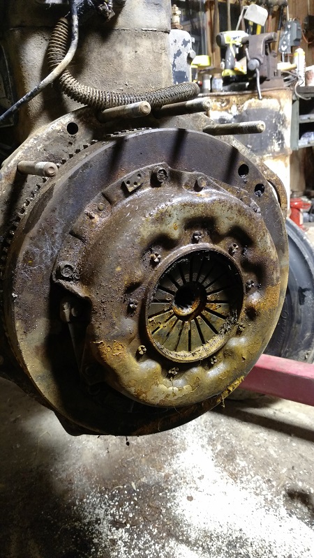

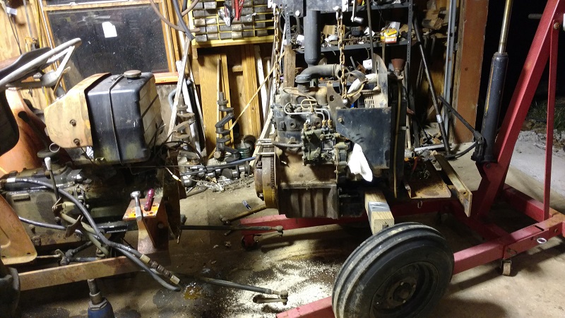

the clutch went out on my 5020 a couple of years ago, and it became one of those projects I never got to.  finally brought it in the other night to start the project.  tractor has been sitting outside.  On the left side of the clutch housing is a large inspection hole.  Discovered that the housing was filled with water.  Checked the parts book, it doesn't show a plug or anything for this hole.  I had never worried much about it, figured any water that got in would run out the bottom, but there doesn't seem to be any opening in the bottom of the housing.  so, couple of questions......do any other 5020 owners have a plug in this hole?......and what would be wrong with adding a drain hole to the bottom of the housing when i have it apart??  you can see the hole in the pic below.

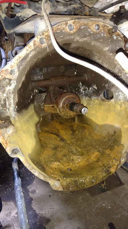

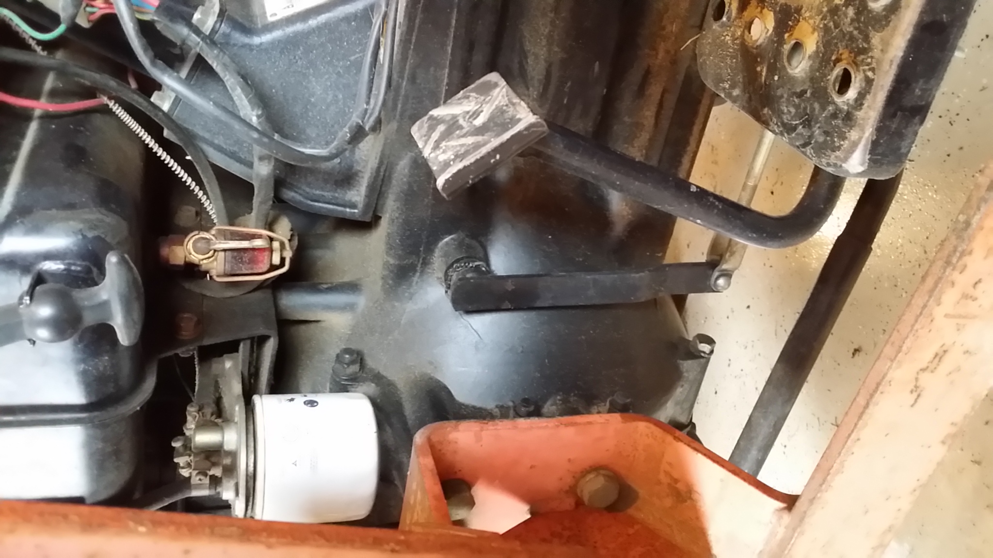

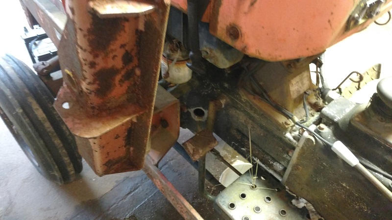

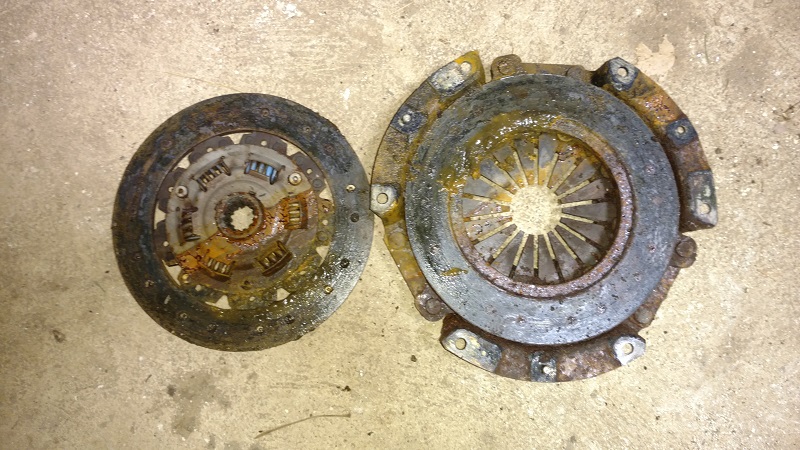

hmmmm.....so is your housing solid at that spot, or is there a knockout or soft plug there??  i'll have to put a plug of some sorts in mine.  in the pic below, you can see the hole from the inside of the housing, and there's some other pics.  its a bit ugly in there.  the clutch disc actually looks OK, thickness wise. i think my problem wasn't the clutch itself, but either the pressure plate was rusted stuck or everything was rusted to the shaft and wouldn't move.

Alan, almost every tractor manufacturer always drilled a hole in the bottom of the clutch housing and then  put a cotter pin in the hole with a loose fit after bending so that the vibrations and movement of it would keep the hole open so any oil that leaked out of the engine or the transmission would drip out instead of filling the housing and soaking the clutch disc. In your case, I would add the hole to the case and then find me a rubber expanding plug to fill the hole you have on the side to prevent water from entering the housing again.

Sure looks like it's been standing about half full of water doesn't it?  Leon R  Cmo

i would be checking the transmission and changing the input seal with that much water in there

Add hole to bottom and plug the side hole! In japan they run in rice paddies in water up to foot boards and such. Most compacts had a drain plug in bottom. Agree with changing seals and brgs also!

  Yes, you can certainly see the high water mark.
I had to drain the hydraulics to split it, which is also the transmission fluid, and surprisingly the hydraulic oil looks OK;  engine oil looks ok on the dipstick too.

Mine is SN.1587, one of the first off the boat. The clutch actuator arm that sticks out the side is different than mine, looks a little "improvised" compared to mine.

go to Lowe's in the plumbing section, expandable drain plug will fill the hole
