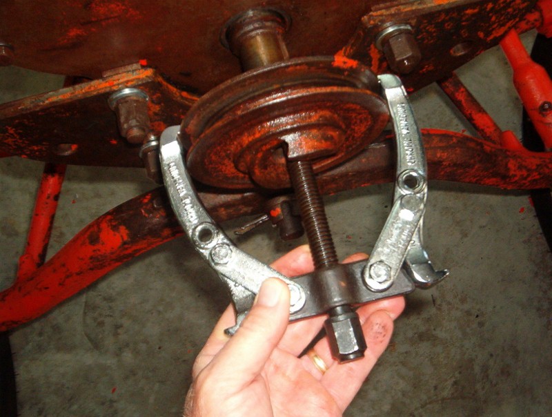

Was a standard puller efficient in removing the main pulley? I noticed on Squids Fab Shop that they had drilled and tapped the pulley to removed it. I am a little nervous that I will get everything tore down, then get stuck on the pulley removal as my shop is in its infant stages as far as tools are concerned. Thanks again.
Dick L View Drop Down
Location: Edon Ohio
Points: 5087
Post Options Post Options   Thanks (0) Thanks(0)   Quote Dick L Quote  Post ReplyReply Direct Link To This Post Posted: 01 Aug 2011 at 12:48pm
Some come off easy and some don't. I have broken some. Put a thin plate behind the pulley to even the pull on the flange and heat the hub on the tuff ones. Heat the hub, not the crankshaft. Don't forget to check for a second setscrew in the hub. Most have one with a lock nut. I have found where a short allen set screw was used and another placed in on top of the first one. Now I put very little pressure on the pulley with a puller before getting the torch.  If you want to drill and tap the hub it would be the safest way but you might still need heat. I do have one with a pulley that has been drilled and taped. I didn't use the holes. The big three jaw puller was already out and me being on the lazy side I didn't take it back and hunt for the bar puller.

I agree with Dick- you need to heat the pulley good and hot.  May need to spray the shaft with a penetrate oil.

You never forget the sick feeling you get when you brake a pully. Don't take a chance pulling a stubborn one cold.

Well, I lucked out..as mentioned before, my shop tool supply is limited so no torch yet other than the mini-propane which might have got it red after a few bottles but it came right off cold, with no issues. Now I have the cover off and am trying to figure out how to get the two washers off that are behind the pulley it appears that the piece the washers push out against is part of the crank shaft and does not appear to be something that will slide off. Thanks again for the education.

That there is a fast way to a broken pulley.
My neighbor make a special puller fore the Farmal Cub front pulley that is pressed on. It has purpose made plates and it uses a hydraulic jack. That way you get an even straight line pull and the plate bares only on the radius of the pulley where it is strongest. Many people have broken the pully then call us for the tool as it is the only way at that point with the outer edges all gone. Problem is i doesn't fit the larger B.C, C pulleys.
