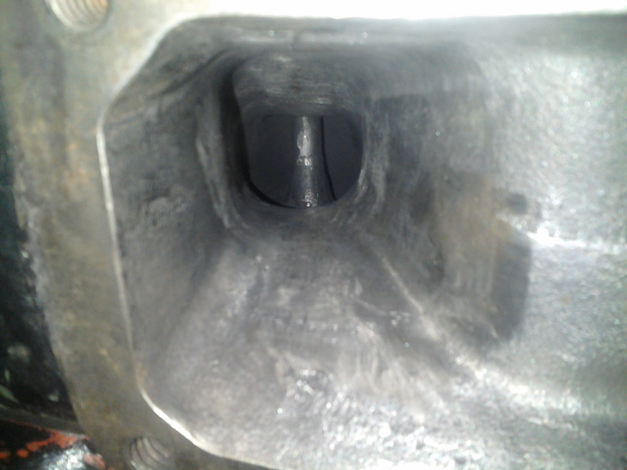

  Tyler, I purchased a head from from a guy named Max where he opened up the bowls above the intake valves, lots of material to remove and polished both ports.  He also cut off the guides that protrude into ports. Took head to flow bench, intake hit 180 at 500 lift after that didnt gain, exhaust hit 200 at 550 and was still climbing.
 To me the intake port is too small and in the middle of port it narrows, a big no no.             I have since opened up the ports middle and the roof making it taller and some what squaring it, never touched floor of the port, thats where the art of it comes in and need more research or leave it to expert.

Post Options Post Options   Thanks (0) Thanks(0)   Quote NEVER green Quote  Post ReplyReply Direct Link To This Post Posted: 28 Feb 2016 at 12:28pm
Stock intake port

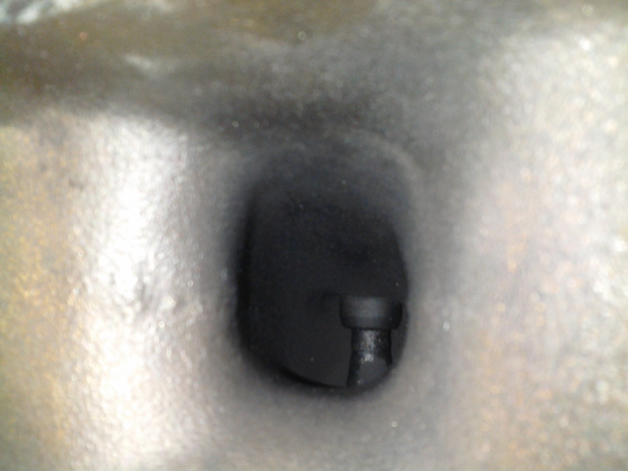

Post Options Post Options   Thanks (0) Thanks(0)   Quote NEVER green Quote  Post ReplyReply Direct Link To This Post Posted: 28 Feb 2016 at 12:30pm
Not too harsh boys, this is my first head porting job, not exact same port.

Post Options Post Options   Thanks (0) Thanks(0)   Quote NEVER green Quote  Post ReplyReply Direct Link To This Post Posted: 28 Feb 2016 at 1:25pm
 Stupid shadow to left of port.
