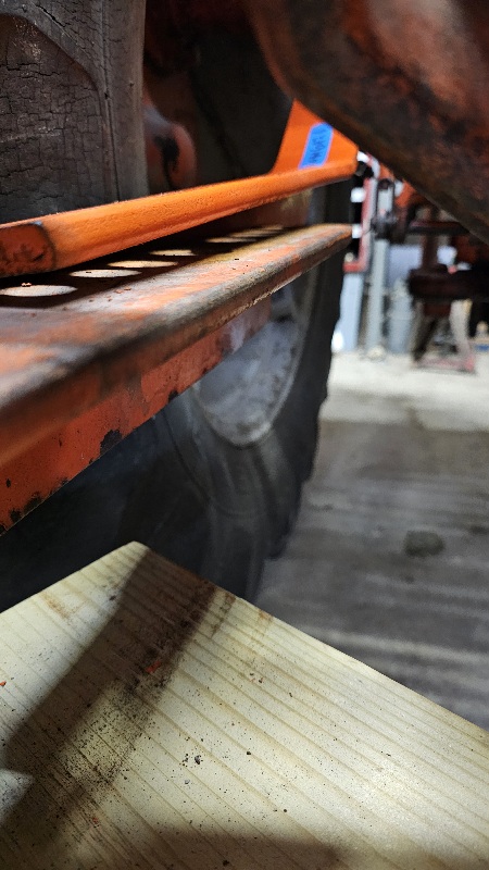

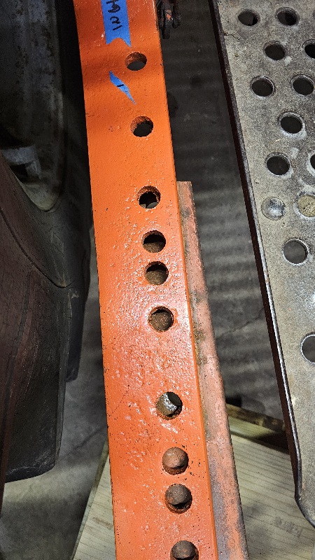

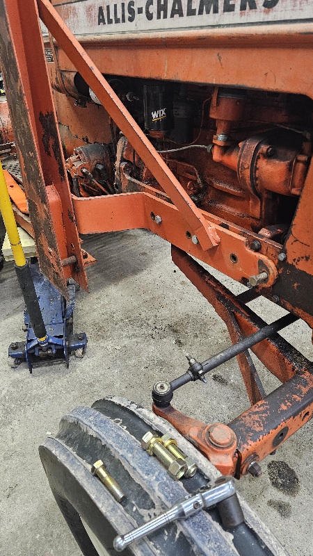

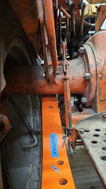

Hello. Im mounting the 415/17 loader to my series 4, D17. The right hand bracket that goes to axle hits the traction control linkage and rubs the hydraulic cylinder. I have a hard time seeing how I could get the ubolt around axle too. Can someone please post a picture of how theirs is bolted on. Thank you

Dr. I swapped them out but they still won't clear the fender brackets.

I have the 17 series brackets but it lines up with the mounting brackets for the fenders.

Dr. Are the finder mounting points at different areas on the axle for the series 4 compared to series 1 thru 3?

Nope. The pre-series 4 doesn't have that TBoost linkage there, but I know the U-bolt goes on the outside of the fender bracket plate. You CANNOT run the rear wheels 100% clear in. They must be out at least 2 inches if not 4 inches.

Ok, i will move wheels out, but even then if i put bracket on the outside of fender the holes are off from bracket to loader

Also there is a gap between the angle and the axle like a 2 inch square tubing could fit between bracket and under/rear side of axle.

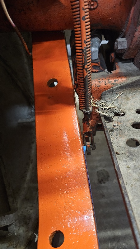

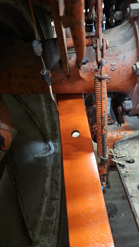

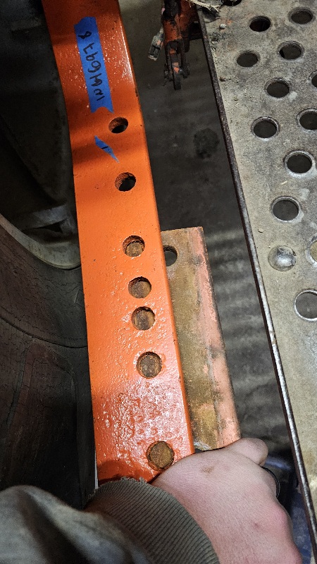

This is with ubolt snug to axle. But im out of threads and can't tighten anymore. They are agco part number for this loader.

Id measure between the uprights with the frames mounted to the front of the tractor. If that doesnt match the boom width you would know if you need spacers

I think I found the issue. One of the angles are bent pretty good. I put the other side together and it lined up almost perfectly. I was having a heart attack after how much cash I have sunk into this. Will update soon

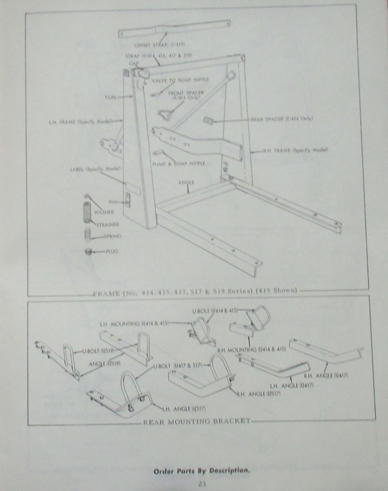

Then had a look in the Allis TM-328 Operating Instructions and Parts Illustrations 400 and 500 Series Loaders.
On Page 10 is an unusual Picture.
Fig. 7 is tagged as 417 R/H Rear Frame Mount - 'U' bolt is inside the Fender
Fig. 9 is tagged as 517 R/H Rear Frame Mount - 'U' bolt is inside the Fender
Wouldn't the 517 have to be on a Ser.IV with the Live Hydraulics, like Josh's?

It not only hits the linkage but also the 3point cylinders. So it has to go on the outside of the fenders. I was hoping for a 500 series loader but for $350 for this 417 I couldn't pass it up.

pic out of loader operating instructions (form tm-374)

No spacer needed for a 417 loader, two things come to mind, one something is bent or it's badge wrong, I would guess it's bent or maybe the angle that the rear mount goes on has been broke and rewelded. I put a 415 on my D17-1 and had to rework the mounting brackets. When you run out of threads on the ubolt clamp put some more washer or something to be able to pull it down further and like Dr. said leave thing loose until you've every bolt installed. HTH.

Thanks for posting that picture. It is very similar to the one I was looking at.
But it is different. If you look close you can see a bit of the 'Live' Hydraulic Pump hidden behind the Loader Frame Upright.
Also it looks like you can see the Traction Booster Linkage mounted to the Axle Housing.
That is the Picture Josh needs.
Am I seeing correctly, the 'U bolt' is between the Fender and the Wheel, and the Traction Booster is by itself inside the Fender Bracket?

Traction Booster linkage and the lift arm cylinders are unique to the D-17 IV, One-Seventy and 175 tractors.
