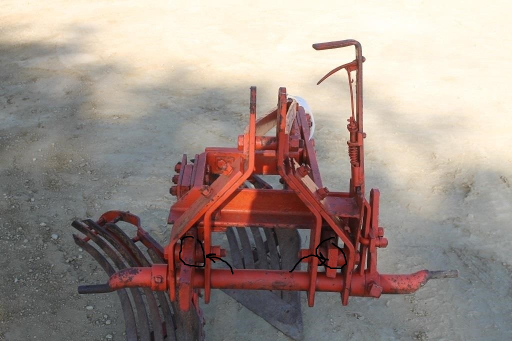

See pic,
What does one think the rational for having the 3pt cross shaft? mounted below the
holes for the sc coupler bar?  Hole not big enuff for requred shaft dia, or to keep with
3pt spec???

Measure the difference between where lift is and where you think it should have been. Raise the plow off the ground. Subtract the difference and see that the plow will be too close to the ground.

maybe it was a quick way to use existing parts ? simple,cheap, easy ??

Seems to me to do the bar dropped down as it is requires more parts than to utilize the existing hole.  I am betting they thought the diameter of the bar had to be wider than the hole could acomodate..
Also when lookling at this, it appears the top link location relative to the plow bottoms cannot be adjusted.  My understanding there is a "sweet" spot depending on the number of botoms, width of cut.

It was designed that way to be able to adjust the tilt on the tree point. Stop trying to over think it!
hmmmm I think I follow....the fact that SC lift arms went significantly higher up than the
three point lift arms makes the difference?
isnt adjusting the tilt done on the tractor three point - i.e. dial up/down the lift arm?
to some extent yes... But by ROTATING the cross bar, the two attachment points to the 3 point are moved FORE- AFT so you can align the rear implement to the tractor..... that beings said, i think Dr is right.... you need to crossbar LOWER so you get more LIFT out of the 3 point.
