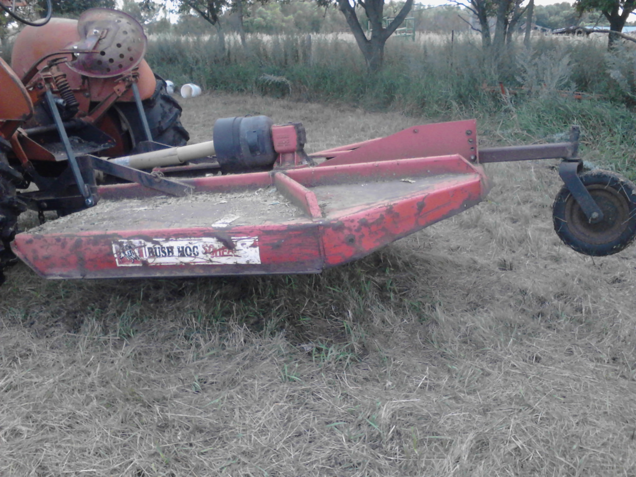

Post Options Post Options   Thanks (0) Thanks(0)   Quote truckerfarmer Quote  Post ReplyReply Direct Link To This Post Posted: 01 Jun 2017 at 6:46am
Don't know if this helps but, I bought this mower that had been converted to snap coupler. He was using chain for the lift links. I made new lift arms from 2x1/4" flat stock with 5/8" rod welded to the top. He used 2x2" square tube for the drawbar.

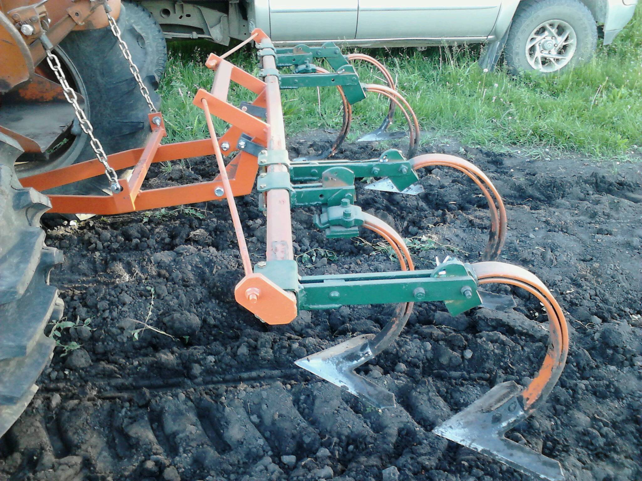

Post Options Post Options   Thanks (0) Thanks(0)   Quote truckerfarmer Quote  Post ReplyReply Direct Link To This Post Posted: 02 Jun 2017 at 9:16pm
Here's a cultivator I built from scratch. Copy of a WD field cultivator.

Post Options Post Options   Thanks (0) Thanks(0)   Quote tony Quote  Post ReplyReply Direct Link To This Post Posted: 02 Jun 2017 at 11:20pm
Looks nice!
