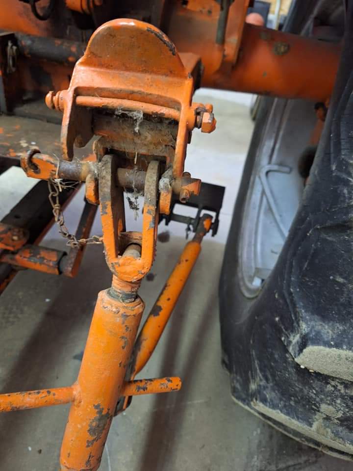

Does any one know who made this 3 point hitch or it's model number?  I have one on the WD45 and would like to find one for the D17.

ooo, I like that one better.  Wish I had one of those instead.  I'm making one for my CA (pre snap coupler) out of a Cross WD45 kit.

That looks like a Saginaw 3 point hitch. I have one on my WD45.

YEP... father in law had one like that on a D17-3 40 years ago.. Dont think Saginaw is in business any more. ......... top link is separate part on most new 3 point assemblies.

how does that hitch fit on a wd45?    i can see how it would fit a d17

Saginaw three point, not in the 3 point business anymore but it think they still make equipment.

Yep that's a saginaw.  The sway control was a problem on them.  The bent end at the lift arm didn't always line up and couldn't be used.  Otherwise a really good design.

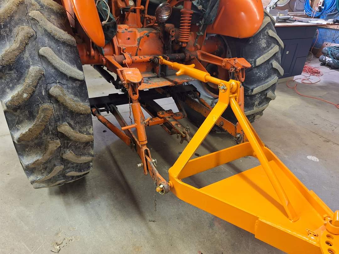

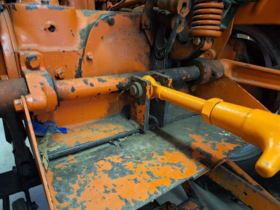

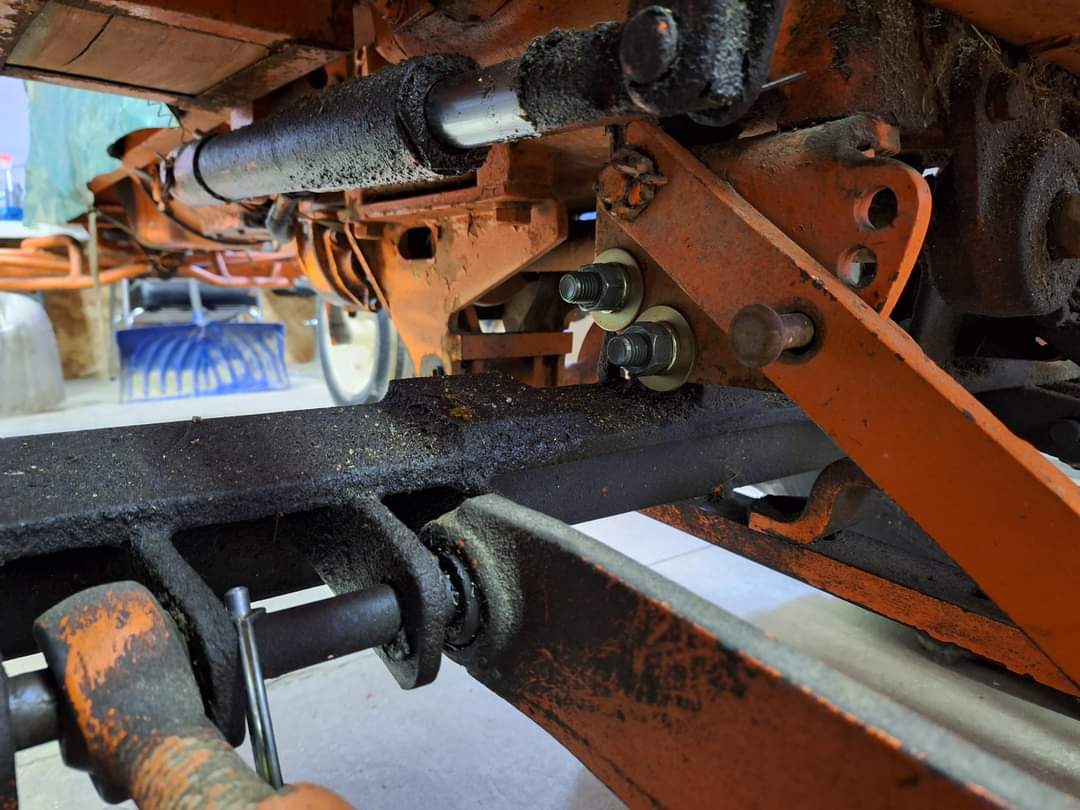

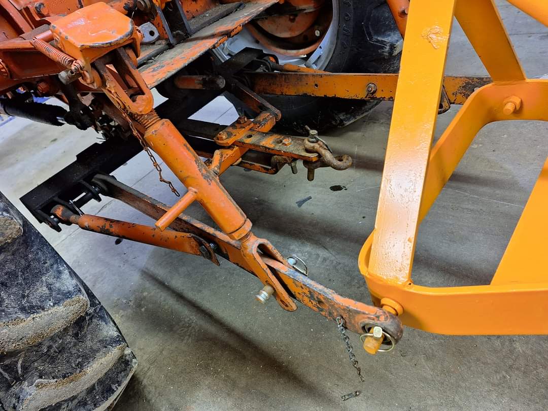

This is my Saginaw 3 point. This was built in the 1970s. It bolts to the drawbar bracket and uses the lift latches on the rocker arms. The top link bracket bolts to the main axle housing.
