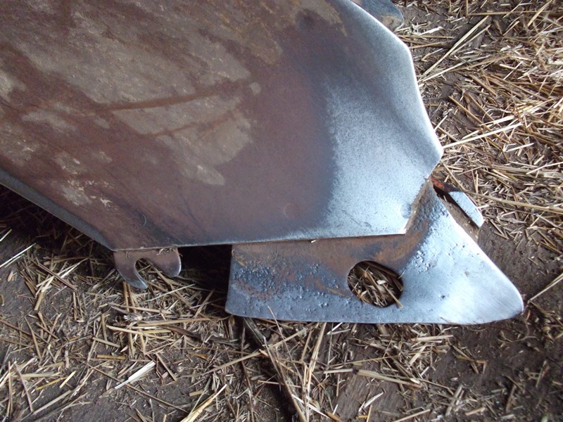

That is what I need, anyone know if there are any remakes of these parts? I do need the J bolt also, but I need the share first.

   Looks like the moldboard is missing some metal too, that was broken off.
  Turn the plow over on the landside and shoot a picture of the bottom, that I can compare the frog and bracing with the illustrations in the plow bottoms book to have a chance of identifying the bottom and then I can post a list of the share numbers to look for. Gerald J.  |

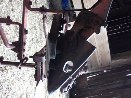

Here are some pics, let me know if you need others to help identify, looking at the plow today, all 3 shares need replacing as they have seen use by the looks of it. Appreciate the help with locating them. I wish someone would make these parts still....

The number on the moldboard  is 309211, the shares say SOLID on the right side on back.

   309211 is the moldboard for a 14" right hand #325 plow bottom. The only application for that moldboard.
  You also need a 308816 bracket, draw rod that bolts to the bolt of the share and a 314586 draw rod. The share provides the front of the landside so its not a simple flat share. These parts were also used on the #25 bottom 14 inch and the bracket was used on the 16 inch #24 bottom. The draw rod was used on the 16" #24, all sizes of the #25, the #54 (only came in 14"), and the 14" prairie breaker bottom with Q.D. share. Share numbers that fit are:308801 (soft center steel), 309246 (alfalfa), 323651 (F.C.D.S {full cut deep suck}), 308804 (solid steel), 308837 (Narrow C.D.S), 308807 (chilled iron), and 309222 (chilled iron, N.C.D.S.). All of these shares were also used on the #25 bottom. I only have a plow bottoms book, no parts. Gerald J.  |
