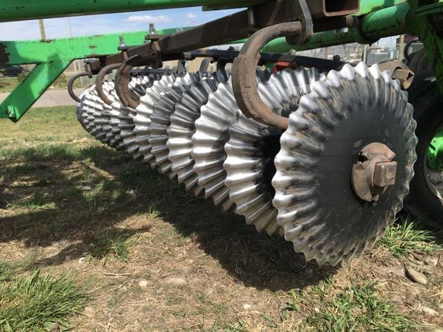

What do you think of this repair?
Its not mine, so you can say freely.

If it works go for it! I myself wouldn't trust welding it like that. If that's spring steel for the flex it will break at the weld before too long.

looks like an old weld, must be working. I do agree with Dan about the spring part, but I have also seen where welding improves where a defect was. if the disk is cheap enough, go for it! also that may be a bargaining tool!

I wonder what happened to cause them to be broke to need welding in the first place??

could have been edge of field hazards or forcing it into terraces? or poor design?

It's supposed to be a spring that "gives a little" and makes hitting rocks and cause a little less damage. That looks like a VT which are very heavy and would be too hard to break hitting a big rock going 8mph.
I wouldn't like that repair because I'd think it would take away the designed spring action. I would replace it instead if I could afford it.

At first I didn't notice there were 2 of them fixed like that.
Well, like all repairs like that, it will work right up until it doesn't. I think it would spring and give just fine, but it will fatigue that repair steel more quickly I would think.

Apparently that guy doesn't have my luck! I would not weld a spring and expect it to last.

Its a first time for me to see something like that… I cant't imagine what he hit to break two shanks?
Its a 22 ft single fold disc, rebadged deutz/allis.
Probably, new shanks are not available and the guy had to get her done.

There is a rod for welding spring steel that works pretty good. If that was used on the shank, then plated I don't see why it wouldn't work good. But if you get it too stiff it will break again.

I'm thinking sistering plates left and right would be stronger than fore and aft.
