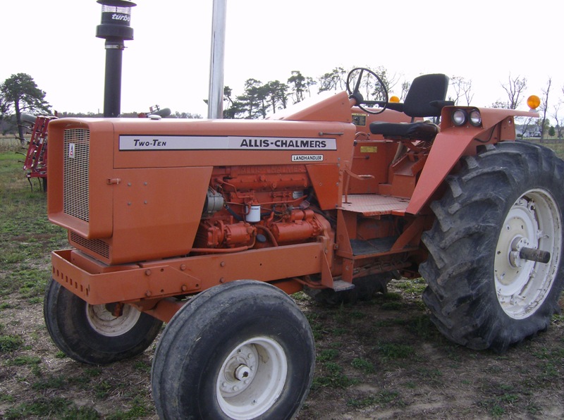

can sombody with a 210 take a couple pictures of the fender skirts and steps please ? we took the cab off and have the fenders to go back the parts book is not very clear any help is apreciated here is where i am at

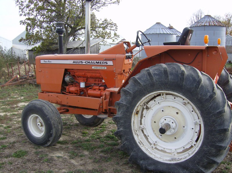

Had these on my computer.
Jordan(OH) View Drop Down
Location: Celina, OH
Points: 1563
Post Options Post Options   Thanks (0) Thanks(0)   Quote Jordan(OH) Quote  Post ReplyReply Direct Link To This Post Posted: 17 Apr 2012 at 11:06pm

the circled parts are what i need i cant figure what iam missing   thanks to all

Number 24 is the cross member that goes between the two reinforcements in the side of the fender. Your fender you have looks to be an older series III 190 fender with the three up and down supports not like a later 200 that had the 2 up and down reinforcments which is like a 220/210. Luke sells them new and also he sells 3 and 2. The 26 piece is if you do not have fender extensions and want to have the fender further out. If you get fender extensions you will not need piece 26. Hope that helps.
injpumpEd View Drop Down
Location: Walnut IL
Points: 5095
Post Options Post Options   Thanks (0) Thanks(0)   Quote injpumpEd Quote  Post ReplyReply Direct Link To This Post Posted: 18 Apr 2012 at 7:32pm
26 is the filler piece for the opening under where 2 is.
