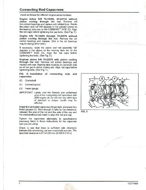

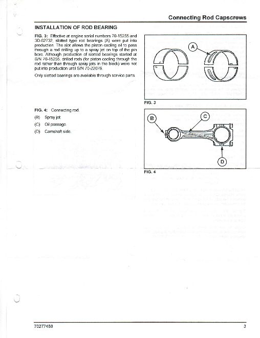

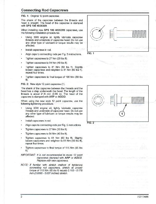

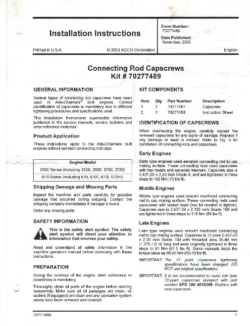

Instructions for Kit # 70277489
 These are for the ARP Bolts

A while ago I replaced the rod bearings in a 426, no noise just preventative measure.  I used the agco bolts and federal mogul bearings.  Like the instructions say you have to turn the rod/piston 180 degrees.  3 of them were pretty easy, 2 took a little work, but 1 was a bear to get turned.  It seemed to hit on everything before it would go all the way around.  Made a couple of long rods with welded ends on to push the piston/rod up and really helped pulling it back down.  I put clear vinyl tubing on them to keep from scratching the crank.
Still going strong.
