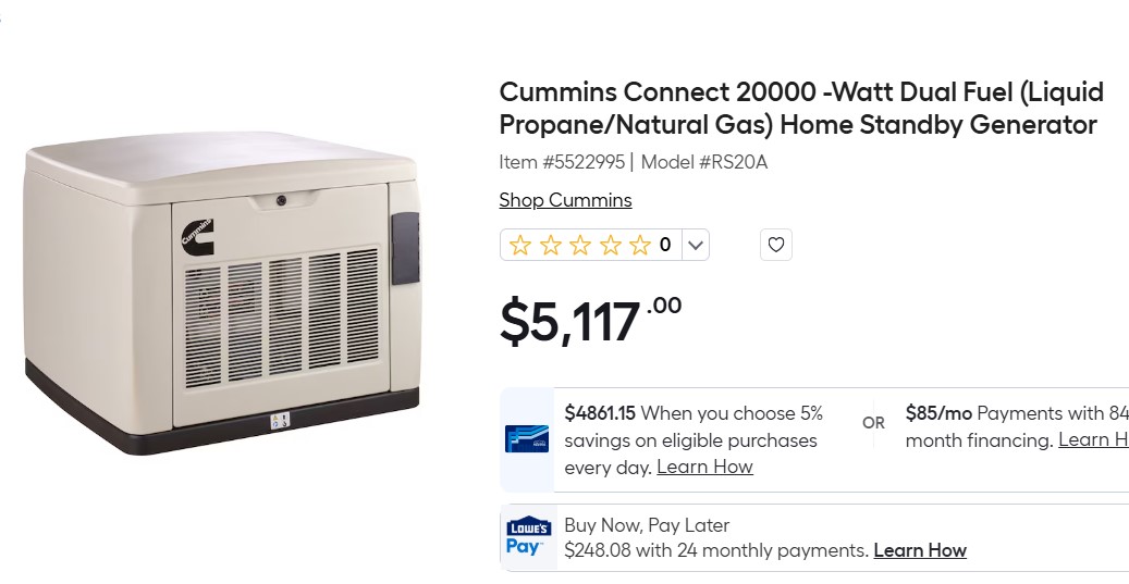

Hey Don, if you want a generator that will power EVERYTHING, we just replaced one of our farm generators and the old one is for sale! 200Kw Onan with a 400hp Cummins. You wouldn't sleep but you'd power the neighborhood

Tyler... how is the FUEL EFFICIENCY on that unit ?.. About 30 gallons an hour ?  Wink Clap
Fuel efficiency??? What's that??

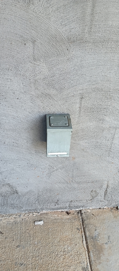

I did this and installed a 10 circuit transfer switch. All switching is done in the transfer switch. It lets you switch each circuit from line to generator power and back. you don't have to turn off your main breaker. You have to use 2 circuit spaces for any 240 volt loads. It also has meters so you can monitor the load on the generator.

Post Options Post Options   Thanks (0) Thanks(0)   Quote Riprock Quote  Post ReplyReply Direct Link To This Post Posted: 17 Apr 2025 at 2:39pm
Outside you just have a Receptacle to plug in the generator cord.
The cover is screwed down in the picture.

Riprock,
Are there any 240 volt circuits or just 120 volt?

Post Options Post Options   Thanks (0) Thanks(0)   Quote Riprock Quote  Post ReplyReply Direct Link To This Post Posted: 17 Apr 2025 at 4:50pm
Both, you have to use 2 circuits for 240, 1 for 120. The bottom 2 circuit switches on mine are for an electric water heater so the handles are tied together. Similar to how a 2 pole breaker is.
 The transfer switch comes prewired with a length of flexible conduit, it just wouldn't work for my set-up so I used pvc instead.
 Since mine is 10 circuits it has 20 wires (10 pairs) coming out of the transfer switch, they're color coded and marked. For each circuit you want to power off the generator you remove the circuit wire from the breaker in your exsisting panel, wirenut that to 1 of the paired wires and place the other paired wire on the breaker.
 That way all switching is done at the transfer switch and since you don't turn the main off when your power comes back on you'll know it by leaving a light on not powered by the generator.
Edited by Riprock - 17 Apr 2025 at 5:06pm
