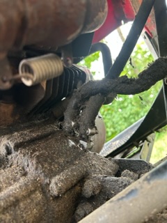

Picture check
Tbone95 View Drop Down
Joined: 31 Aug 2012
Points: 12420
Post Options Post Options   Thanks (0) Thanks(0)   Quote Tbone95 Quote  Post ReplyReply Direct Link To This Post Posted: 19 Jun 2023 at 6:05pm
Ok picture worked. Those are the 3 oil lines connected to the engine. The lowest one goes to the oil cooler, the middle one comes from the bottom of the oil tank, the top one routes to the air box. The oil cooler returns to near the top of the oil tank. Then there’s a line off the very top of the tank that must be a vent. It appears that should be connected to the other port on the air box, it’s the right length and has a clamp on it. It’s currently hanging in free space, guessing that the guy who worked on it last left it off, not me. I can’t imagine that would make any difference.

And you can easily blow through the vent hose, not instructed
