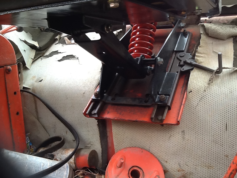

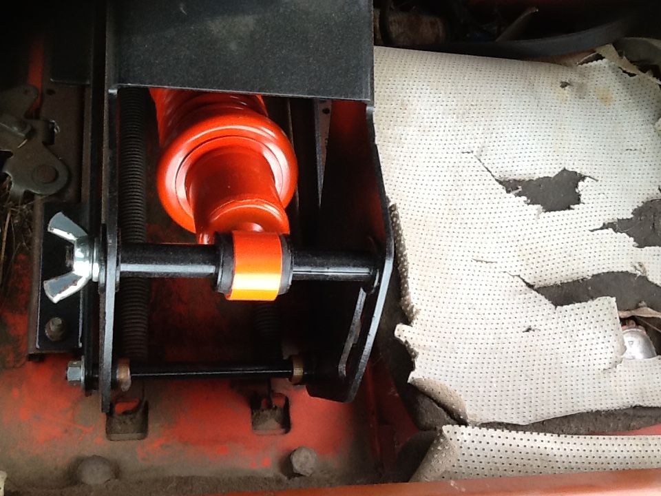

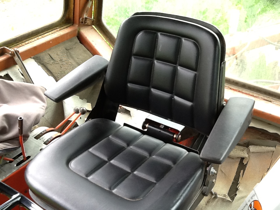

Post Options Post Options   Thanks (0) Thanks(0)   Quote Mikez Quote  Post ReplyReply Direct Link To This Post Posted: 23 May 2019 at 6:10pm
Took some pictures
Wish the rest of tractor looked as good as seat.
Edited by Mikez - 23 May 2019 at 6:15pm

Post Options Post Options   Thanks (0) Thanks(0)   Quote Leadoff Quote  Post ReplyReply Direct Link To This Post Posted: 23 May 2019 at 8:29pm
Mikez,
Your new seat and support assembly looks great.  Congrats on taking the time to maintain the original appearance and functionality of your 200 tractor.

Post Options Post Options   Thanks (0) Thanks(0)   Quote acnh210 Quote  Post ReplyReply Direct Link To This Post Posted: 02 Jun 2019 at 8:30am
Mike, where did you purchase the seat itself at?
Terra Tiger, WD, 7040ps, 8050 with westendorf loader, 8050ps fwa.
Points: 8915
Post Options Post Options   Thanks (0) Thanks(0)   Quote Mikez Quote  Post ReplyReply Direct Link To This Post Posted: 02 Jun 2019 at 5:29pm
A fellow forum member gave me info at the time. You google Serco loaders. It's a forestry log loader and they use that seat. When you look it up find your local dealer. I be leave this is the part number. SERHH1005 and SERHH1106. I had the parts guy send pictures to be sure. It's a nice built seat but not cheap. Good luck
