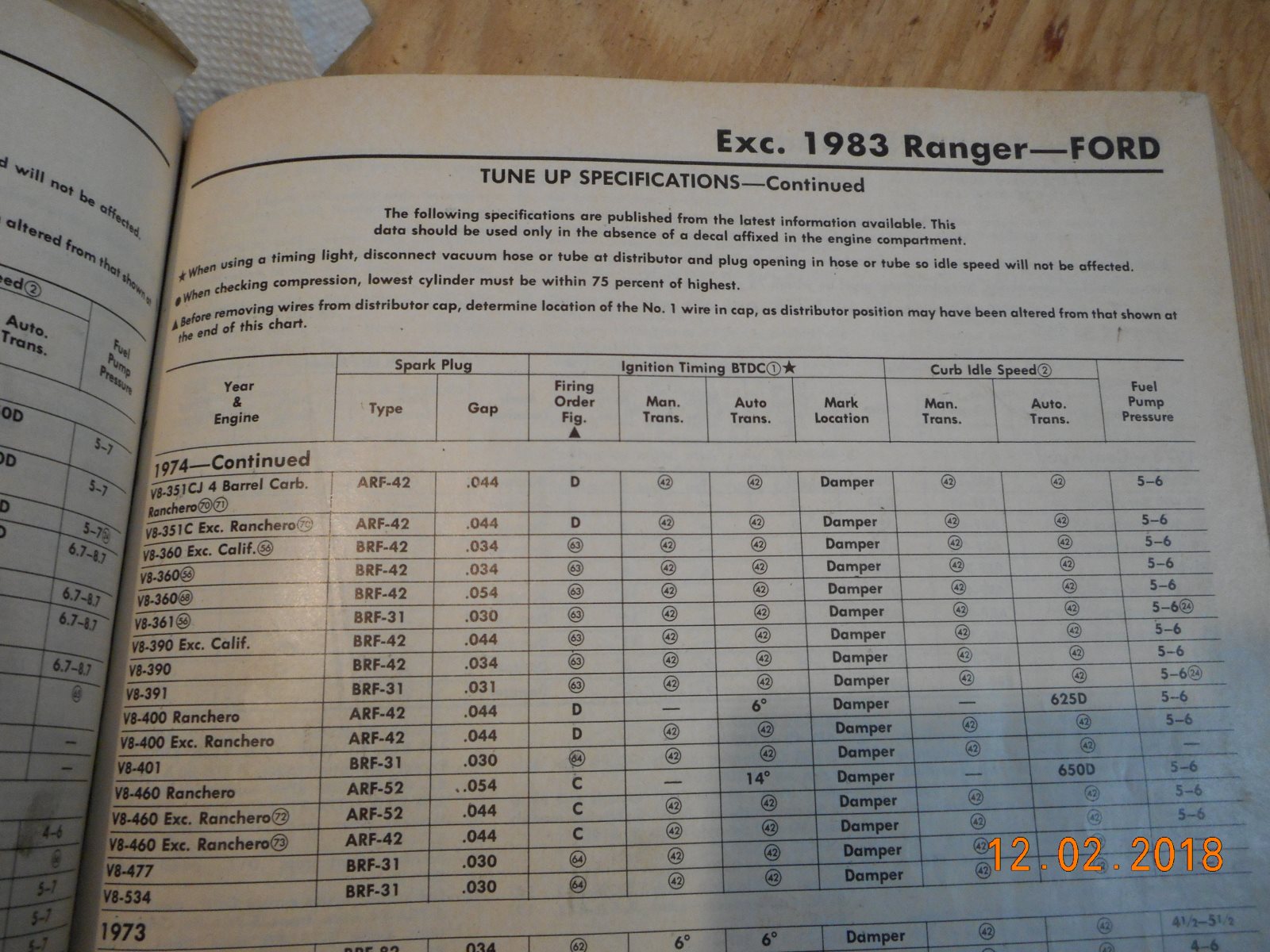

Post Options Post Options   Thanks (0) Thanks(0)   Quote Jim.ME Quote  Post ReplyReply Direct Link To This Post Posted: 02 Dec 2018 at 5:58pm
Pulled out an old MOTOR manual,try this info.
HTH, Jim
