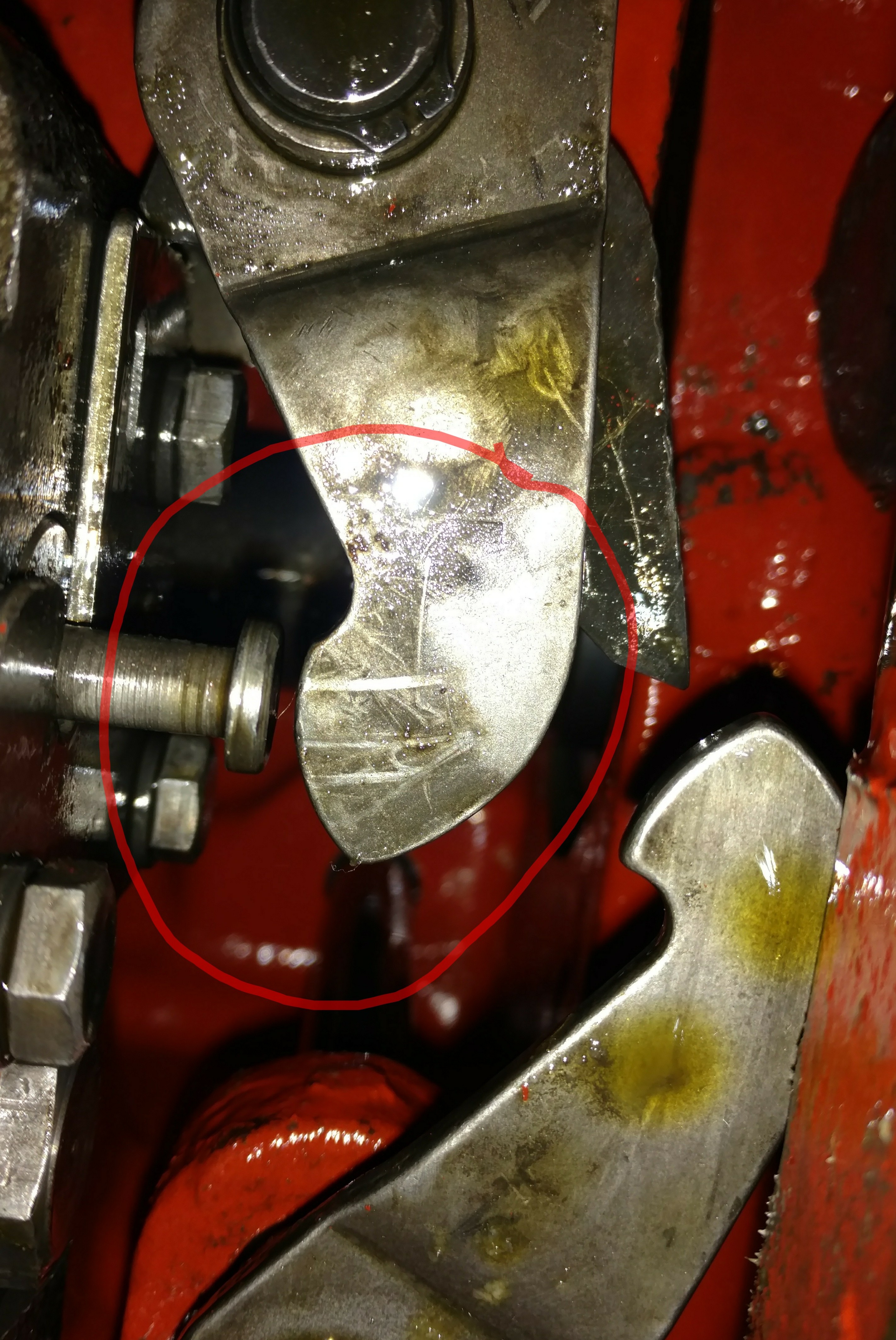

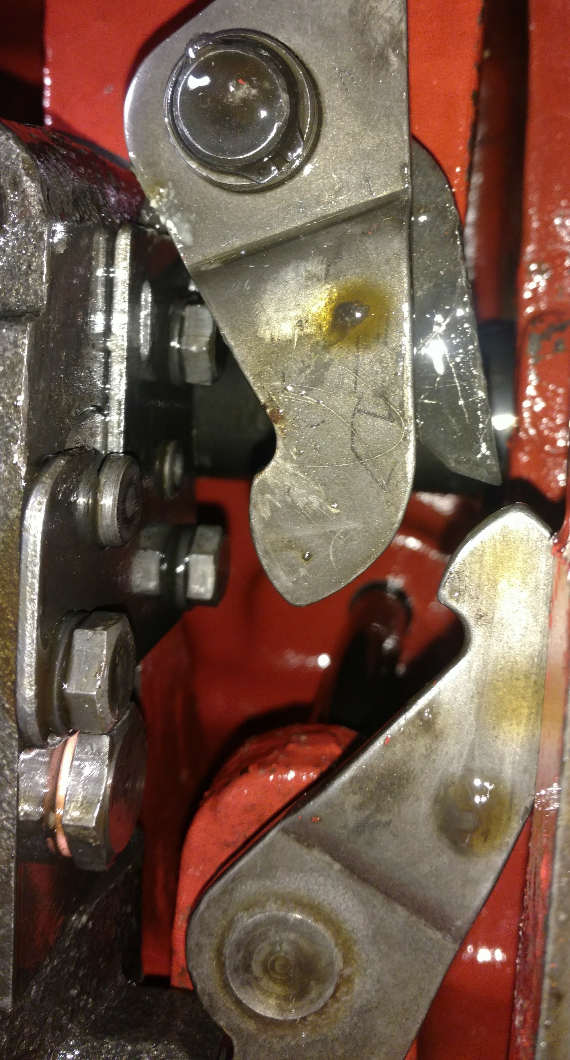

Post Options Post Options   Thanks (0) Thanks(0)   Quote sstevens1985 Quote  Post ReplyReply Direct Link To This Post Posted: 17 Feb 2019 at 4:40pm
Valve stem looks fine and linkage is pressing on it.
The traction booster linkage, the linkeage finger closest to the bottom on the pan is binding on what appears to be a he head boot, the inner finger for the traction booster I'm assuming is suppose to press into the 1/2" or so horizontal slit in the hydraulic pump when the traction booster lever is at the bottom of the quadrant?

Post Options Post Options   Thanks (0) Thanks(0)   Quote john(MI) Quote  Post ReplyReply Direct Link To This Post Posted: 17 Feb 2019 at 8:03pm
Can you put the Boost lever all the way down, look at where the lever would be if it worked and then just use something to move it into that position?

Post Options Post Options   Thanks (0) Thanks(0)   Quote DrAllis Quote  Post ReplyReply Direct Link To This Post Posted: 18 Feb 2019 at 7:25am
The picture doesn't show the hold valve.

Post Options Post Options   Thanks (0) Thanks(0)   Quote sstevens1985 Quote  Post ReplyReply Direct Link To This Post Posted: 18 Feb 2019 at 7:38am
Yup I know, but the hold vavle stem was going in and out as I moved the lift/ lower lower to the bottom or top of the quadrant.

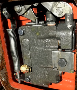

Post Options Post Options   Thanks (0) Thanks(0)   Quote ACthunder Quote  Post ReplyReply Direct Link To This Post Posted: 19 Feb 2019 at 1:07pm
Here is my D17 series 1:

Post Options Post Options   Thanks (0) Thanks(0)   Quote sstevens1985 Quote  Post ReplyReply Direct Link To This Post Posted: 20 Feb 2019 at 9:19am
The part the traction booster linkage finger would push in must be seized or binded in on mine because mine is not extended like yours is in your picture. It doesn't matter where I have the traction booster lever on mine, so I'll see what some penetrating oil will do, if nothing I drop my pump and take a look internally.

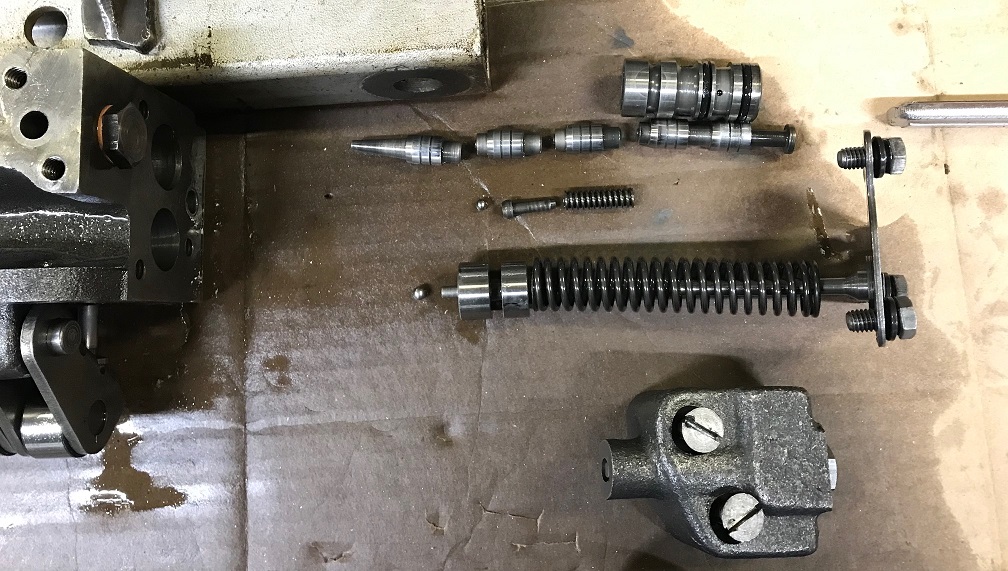

Post Options Post Options   Thanks (0) Thanks(0)   Quote ACthunder Quote  Post ReplyReply Direct Link To This Post Posted: 22 Feb 2019 at 10:07am
Here is a pic of my D17 Series 1 (below 10,000 sn) that I just took apart to replace the seals:

Post Options Post Options   Thanks (0) Thanks(0)   Quote sstevens1985 Quote  Post ReplyReply Direct Link To This Post Posted: 22 Feb 2019 at 10:40am
Any thoughts on how the linkage finger for traction booster will go past that plunger? When I put my traction lever to the bottom of the quadrant it binds against that plunger causing my lift arms to stay raised.
