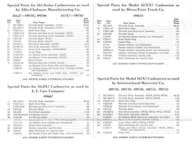

Yup, that's one of the sites where I did some of my research.  I used just about every carburetor related site that comes up in the first 50 pages each using dozens of different search terms.  I found many sites that contradicted each other in various ways.

Here's an extract from an old Zenith PN/price list.  Seems to show PNs 09705 and 09706??
I believe the 9705 and 9706 carbs are from the C, not the CA, so they would be older. They have almost completely different sizes in the jets, vents, and venturi compared to the 11141/11142 that was used on the CA. I imagine those "sized" parts needed to be changed for the CA's higher engine RPM and power output.
Edited by wjohn - 21 hours 29 minutes ago at 7:11pm
