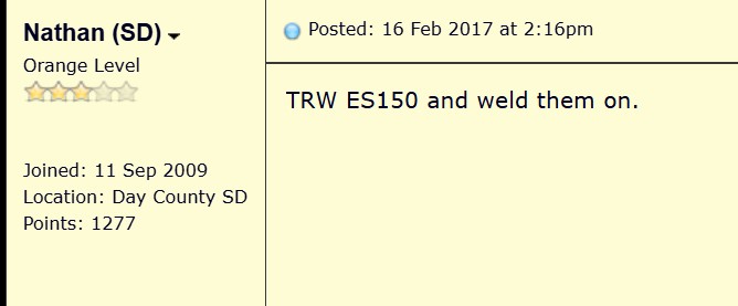

Post Options Post Options   Thanks (0) Thanks(0)   Quote steve(ill) Quote  Post ReplyReply Direct Link To This Post Posted: 9 hours 60 minutes ago at 6:45pm
from an old post...........
