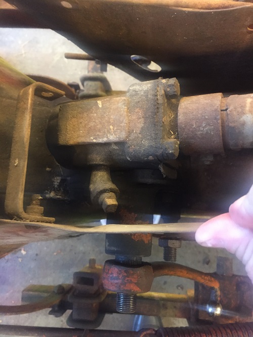

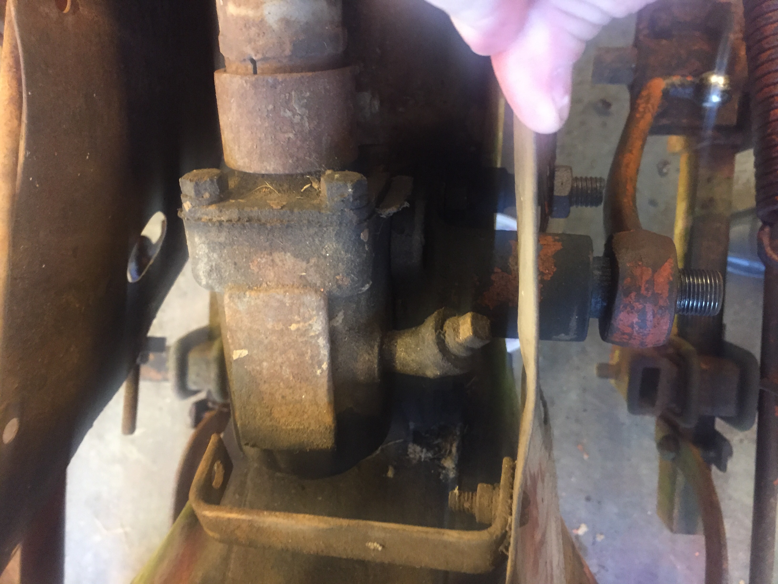

This might help
Dick L View Drop Down
Location: Edon Ohio
Points: 5087
Post Options Post Options   Thanks (0) Thanks(0)   Quote Dick L Quote  Post ReplyReply Direct Link To This Post Posted: 31 Oct 2018 at 11:05am
Looks like a B steering box from that angle. Could you take a picture showing the linkage from the front to the steering box including the front axle?
Edited by Dick L - 31 Oct 2018 at 11:09am
Points: 88129
Post Options Post Options   Thanks (0) Thanks(0)   Quote steve(ill) Quote  Post ReplyReply Direct Link To This Post Posted: 31 Oct 2018 at 1:02pm
like Dick said........ look at the front end linkage.. Does this gear box have a long rod that connects under the radiator, or does it connect to the left front wheel king pin area ?

Post Options Post Options   Thanks (0) Thanks(0)   Quote siev2000 Quote  Post ReplyReply Direct Link To This Post Posted: 31 Oct 2018 at 10:30pm
front left king pin connection

Post Options Post Options   Thanks (0) Thanks(0)   Quote Dick L Quote  Post ReplyReply Direct Link To This Post Posted: 01 Nov 2018 at 6:55am
I will resize your pictures if needed so we can help figure out what is going on. A side picture of the tractor might be a help.
