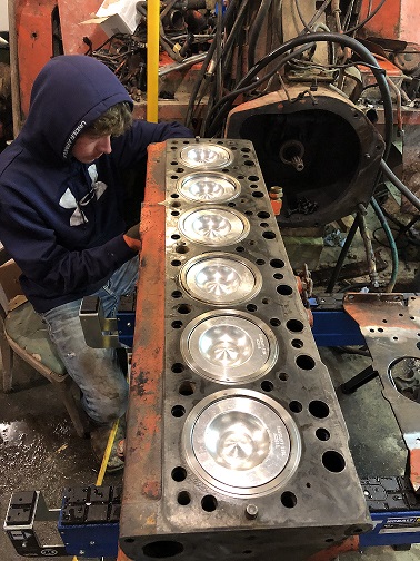

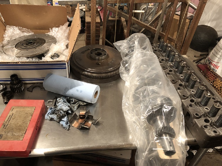

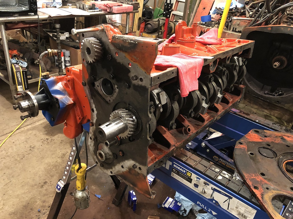

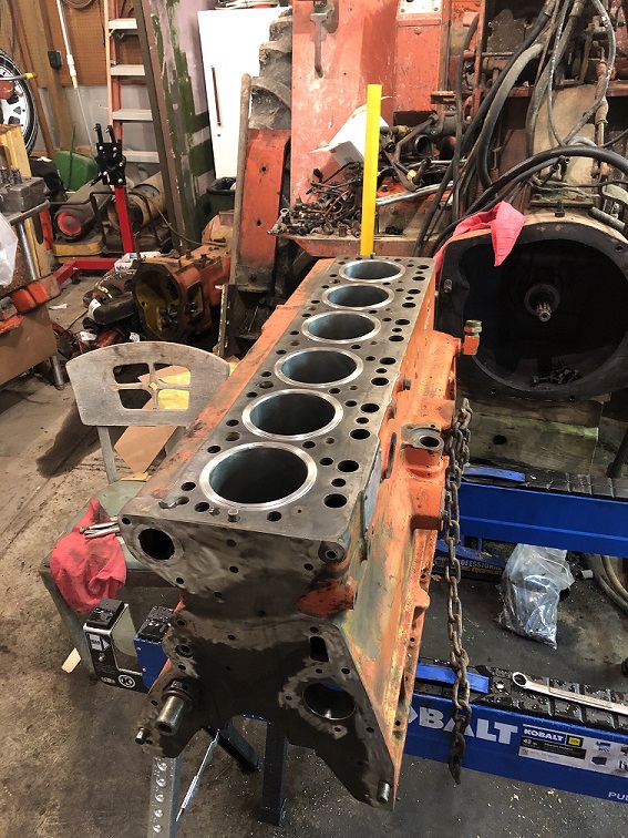

Just wanted to share some pictures of what you all have made possible!!
Just some of the machined parts. Awesome looking clutch (thanks Rick!!)
New liners are in!! Only requires 2 orings!! On my next one I'll take sleeves to machine shop and get one cut in between the two! (Great idea MACK??, That would help if there is much eroding in the block)
New pistons (Got some extra help on the weekend.. guess he gets free rent this week)
Couple new gears.. Thanks Albert for helping me with the pump gear!! Had to go to AGCO for the crankshaft gearOuch. New water pump.. she better run cool, mains, rods, wrist pins bushings, camshaft bearings. Toaster oven isn't for when I get hungry, well I guess it could be, use it to heat up my gears before pressing them on!
