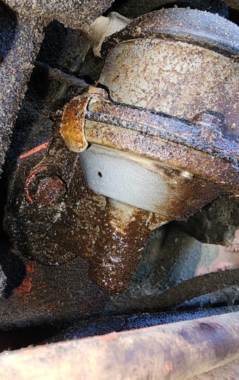

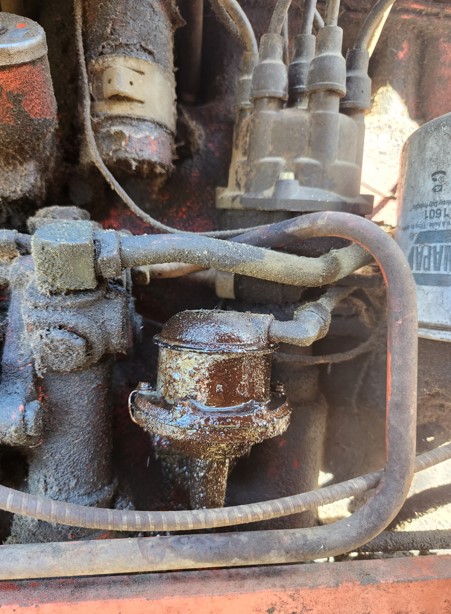

Hey everyone,
I went and started up the good ol' 1968 190XT (Series 2, I think) today to get some bush hogging done. It hasn't been started since this spring for plowing. I checked oil and all that good stuff, put in a fresh 20 gallons of gasoline. It started up just fine as it normally does, no issues at all. However, I noticed a fuel leak from what appears to be the fuel pump. I found what looks incredibly similar in the service manual (Page 194, see attached), but I believe it's a little different. The manual also says the G-2800 could have a carb, but it looks nothing alike. I will attach two images as well to show the component/leak.
When I first started it, the leak seemed like a lot. The radiator fan was blowing back against it and causing the fuel to spray all over, so it was very hard to decipher where the source was. I decided to at least let the engine warm up completely at idle (2,500 RPMs) before shutting it back off. Once it had run for about 15-20 minutes, I checked again and the leak was much less severe. I could also now tell that it was coming from what looks to be a relief hole in the lower-half (see attached). If I covered the hole, the leak would stop and the engine appeared to run exactly the same. This is where bad ideas happen.
I decided to plug the hole with some putty to get me through the brush hogging, and then I would dismantle it later and repair it properly. I went out bush hogging for over an hour with zero leaks or issues. Then I had a small hiccup in RPMs. It only lasted a couple seconds and went away. A little bit later the engine did more than hiccup and stopped. I shut it all off, turned off the PTO, etc. Restarted the engine and it idled just fine. I put it in gear to drive it back to the house and it died as I let off the clutch.
I am assuming these two are related. I currently have it sitting in the field. The putty is still in place and sealing the leak effectively - which I realize may be the cause of my current issue.
When I first started the engine today, it appeared the leak was from somewhere on the upper half of the fuel pump, but later, after it died down, it was only from this relief hole. Would anyone have any insight as to what the original issue was, why it changed as it warmed up, and why it shut down after over an hour of running hard?
Thanks!

I would say the diaphragm is gone in the fuel pump, and with the blocked up drain holes the excess fuel has gone into the crankcase and seriously diluted the engine oil.  It may have damaged the bearings.

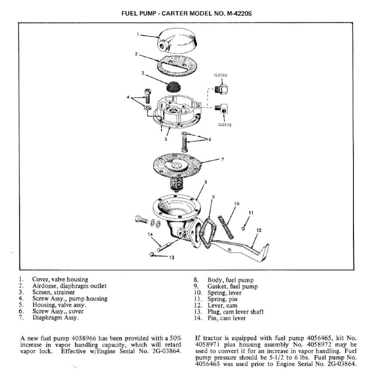

I believe the rebuild kit for that pump is CK-4220, available from 'Then and Now Automotive' in Weymouth, MA. Very nice folks to deal with. And they can confirm for sure that it's the part number for the rebuild kit for the 190XT's pump (I'm 99.9% sure it is, but I am going from memory from a few months ago, so there's a chance I'm wrong). And if that's not the part number, they can put together a kit for yours. They list a few kits online, but have way more in-stock and all the parts make rebuild kits for just about every mechanical fuel pump. I've got three rebuild kits for mechanical fuel pumps from them.
Just make sure you get the check valves around the right way when you assemble it - I've had to re-do a few pumps that folks have tried to rebuild and foolishly put both check valves in facing the same way.
As an alternative, you can just get a cheapo $30 electric fuel pump from Amazon. But it absolutely needs to be no more than 4 psi - preferably less. Or if you do use a higher-pressure pump, you'll need to put an external regulator on that you can use to reduce it to 2-4 psi. That's what I did for my 180 gasser with the 2800 when its fuel pump went and I needed to get it going asap.

I did call them as you suggested and they were very helpful. The nice gentleman was not in love with the AC part number from the service manual as that's "just a number they used", which makes sense.. But isn't that also kind of every model number for everything? He wanted me to confirm it was a Carter M-4220S as the service manual states, but I couldn't find any identifying info on the fuel pump itself other than the AGCO part number presumably as it has a 7 in front of the AC part number. It also has "113" or perhaps "118" below that. These numbers are stamped on a thin metal tag held on by one of the bolts. Other than those, it just says "Made in USA" and "Made in Canada" on two different parts of the body. No other numbers or letters. He didn't like the AC number, but perhaps the AGCO number will be better? I called back but had to leave a voicemail. I'll see how that progresses. I'm assuming it's not a carter pump and was replaced with the AGCO equivalent at some point before I bought it.
Regardless though, thanks for the input! I appreciate the lead.

I had exactly that problem with mine now that I come to think of it: Both his reference book and the Allis service manual indicated that it came with a Carter 4220 pump, but I had no markings on my pump to confirm. I ended up just buying the 4220 kit and hoping for the best, and it was indeed correct. If I remember (feel free to remind me) I'll take some pictures of mine tonight so you can compare to yours.
