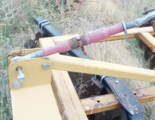

I measured mine today, didn't turn it in because I didn't want to disturb the residents(wasps). Measuring what it is now and amount of thread sticking out I think it will go to 21" center to center. I also measured the aftermarket that I use, it also goes to 21" center to center. I took a picture of one my brother shortened, I think the last time it was used was on a JD 70 with the aftermarket hitch. Not sure if it was shortened for the tractor or for the disc.
Ted
