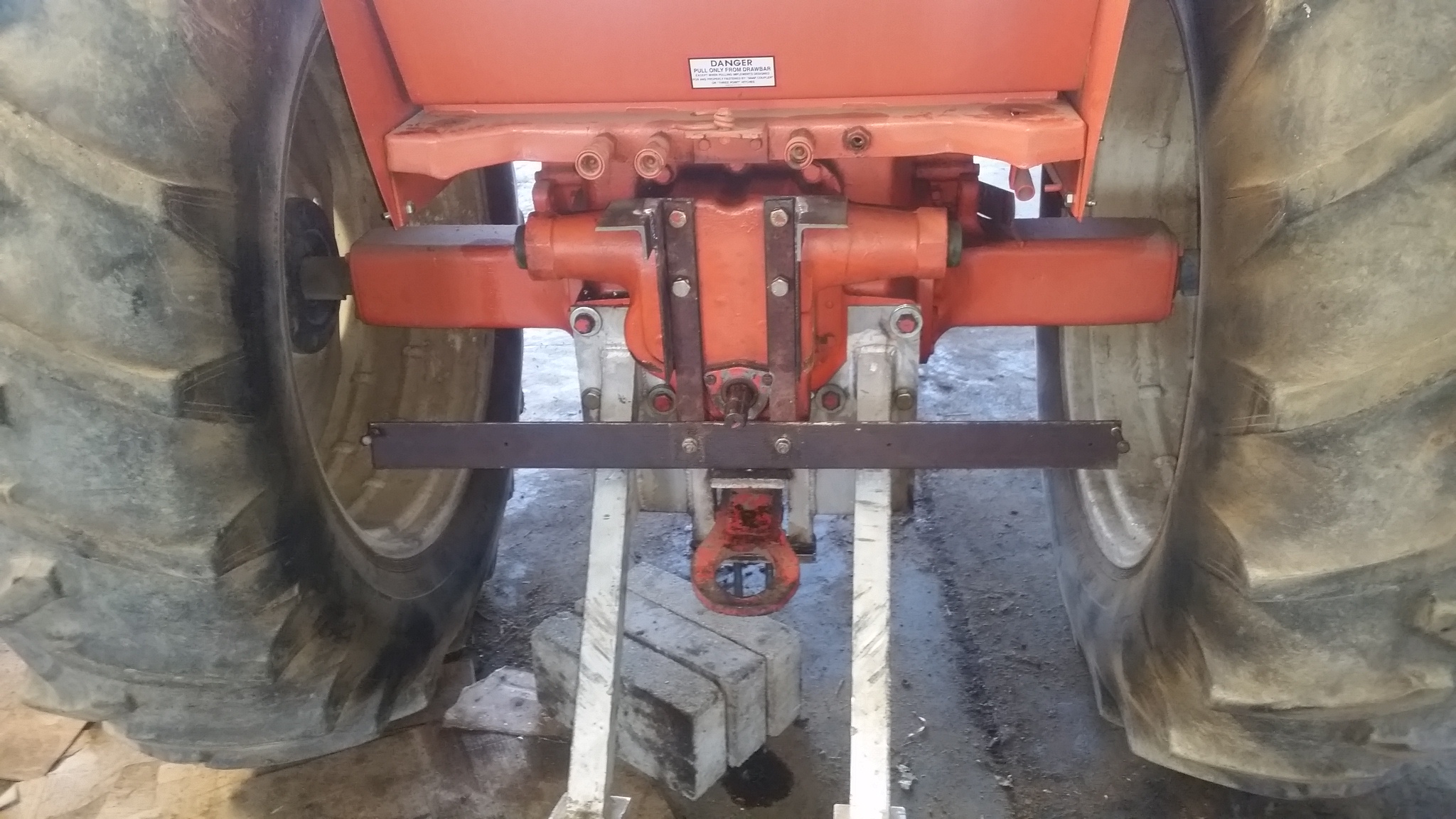

Anyone have pictures of a rear weight bracket for a 190?
Farm class
I was thinking of removing the top link bracket and making something to mount to the 4 bolts there. Strong enough for 1000 lbs?

This is what I am using .

Thanks!
Do you find that short or long drawbar works best?
Height?

that was a test hitch and I Could not get the tractor to hook up.
I run a longer hitch now works great

My hitch is adjustable from 18 to 20 inches
I most pulled round hear run 20" but some go to 18
