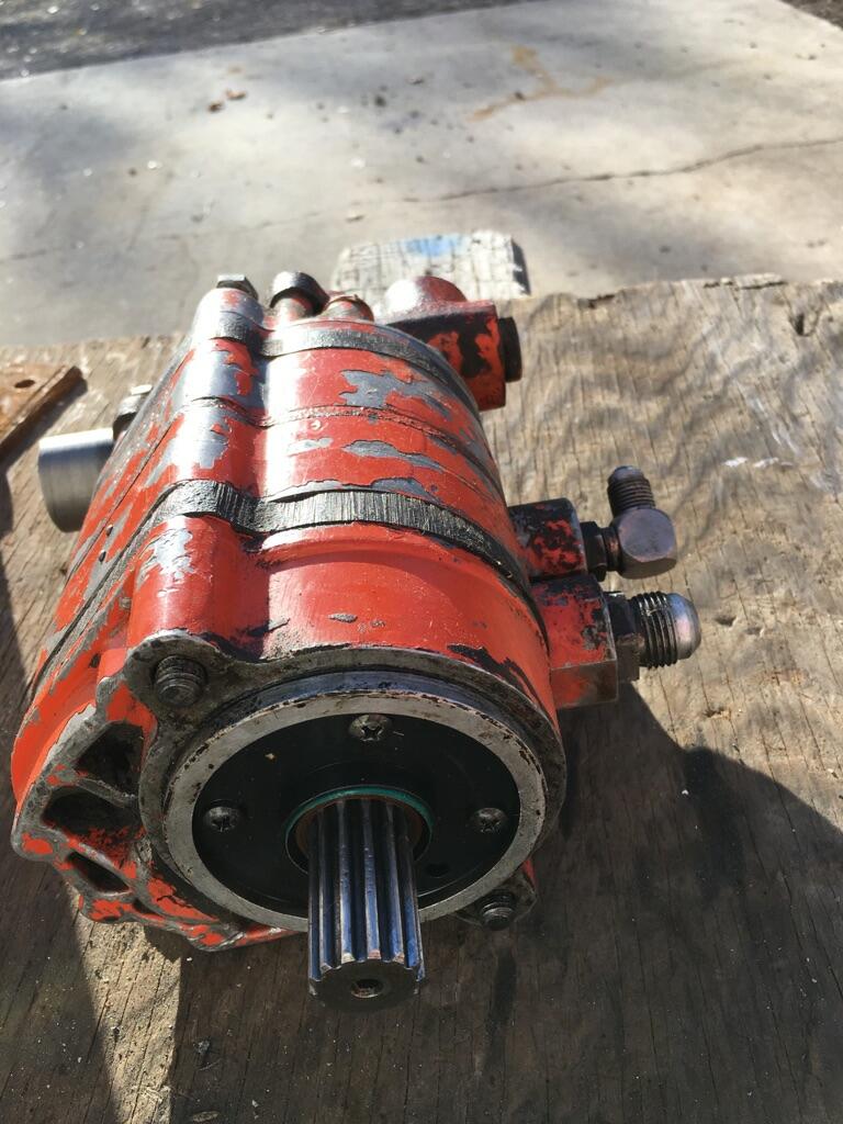

Have a customer wanting to order a replacement hydraulic pump for his 190.  I've look at the pics of his, and cant tell if it's the dual or single .  Is there something I'm missing to be able to tell which he has?

Let's assume it's NOT a very late-model 190XT that has a hydraulic pump like a 200 tractor does. Older model 190's had a hydraulic pump all their own. If it has a single pump, that is for a tractor with no hydraulics whatsoever, other than power steering/power director. A tractor with a dual pump has hydraulics and no 3-point hitch. A tractor with the triple pump has 3-point hitch and hydraulics. A SERIAL NUMBER would help determine the style of pump it has.

Serial 190-1888D. Pretty confident it's the triple, but I'm never ashamed to admit when I'm not confident.

That would be the "triple" pump......one for Power steering/Power Director/PTO clutch......one for remote outlets and 3-point hitch......one for the Traction Booster system on the 3-point hitch.
