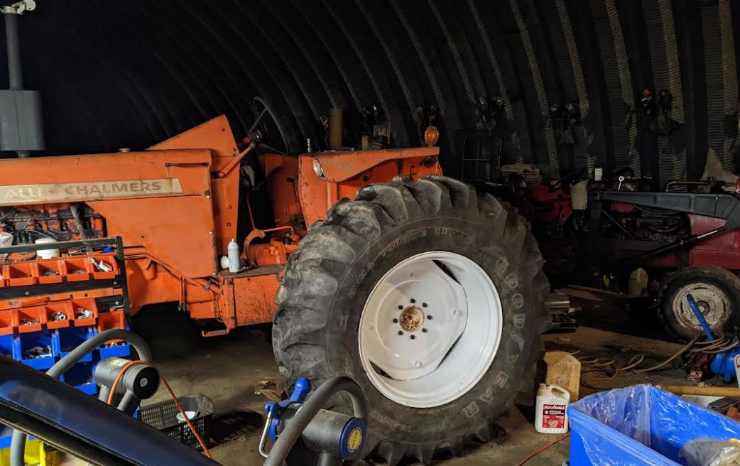

Are the 28's on it now 18.4's? You'd probably be able to find 28" rims without too much trouble. But finding 28" rims wide enough to accept 18.4's would be tougher. Probably easier/cheaper to fix or replace the power adjusts. Because I'm cheap/lazy I don't bother trying to find wheels/centres with matching bolt patterns. I buy whatever used tires/rims/centres are cheap and have decent rubber and solid rims. Then get discs cut on the plasma table at work with the right bolt pattern and centre hole. Cut a disc out of the old centre, weld the new one in, a little grinding/paint, and they look pretty good. I'm sure the purists here would criticize me, but it works for me. Cheaper and easier than trying to find the right centres. Pic below is a set of 18.4-30 rims and tires from a log skidder that I converted for the 180. I paid $200 total for the rims and tires. Discs to convert were less than $100, so in total was a really cheap way to get decent rubber and rims.
