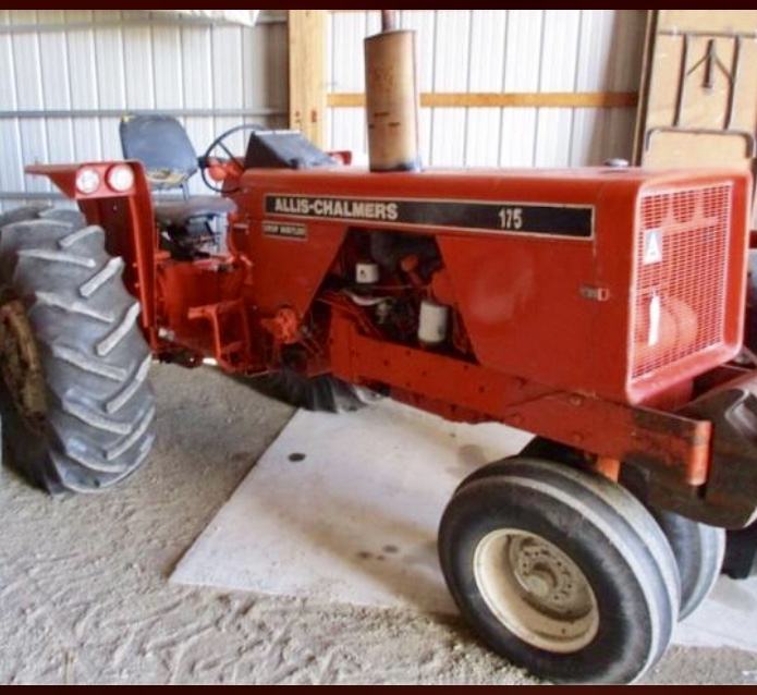

Post Options Post Options   Thanks (0) Thanks(0)   Quote AC7060IL Quote  Post ReplyReply Direct Link To This Post Posted: 09 Apr 2020 at 11:29am
Not mine. An Internet photo of Serial number: 175 1481
