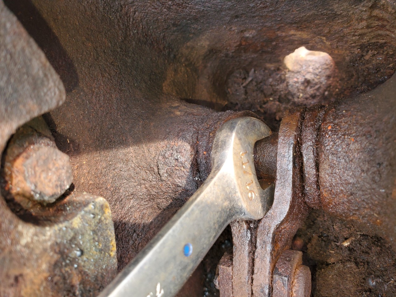

Well here is todays fresh hell:   Yes the pin used to hold the lower brake pan has sheard off inside....
Here is the inside part...notice there is a collar of sorts that my wrench is around (almost), also note the washers....neither are in the parts illustration I show. Thanks Allis!....also wonder why the other brake surface shown here:
https://www.facebook.com/awtractorrepair/photos/pcb.1165431930518991/1165426223852895/
Is not on this illustration?....Oh, well my inner OCD computer programmer coming out...
Looks like this will be it for a while on this project as I am going in for rotator cuff surgury Thursay and will be out of commission for a while...
Thanks for all the help!

Post Options Post Options   Thanks (0) Thanks(0)   Quote TomYaz Quote  Post ReplyReply Direct Link To This Post Posted: 18 Oct 2020 at 7:18pm
oops forgot to add the econd pic:

Post Options Post Options   Thanks (0) Thanks(0)   Quote TomYaz Quote  Post ReplyReply Direct Link To This Post Posted: 18 Oct 2020 at 7:19pm
BTW wasnt me who sheared that off...thats how I found it.

Post Options Post Options   Thanks (0) Thanks(0)   Quote DSeries4 Quote  Post ReplyReply Direct Link To This Post Posted: 18 Oct 2020 at 7:34pm
That pin does not have to come out.  Take the small pin out that is below the wrench instead.

Post Options Post Options   Thanks (0) Thanks(0)   Quote TomYaz Quote  Post ReplyReply Direct Link To This Post Posted: 18 Oct 2020 at 7:36pm
Its gotta come out.  brake rod is sheared off underneath all that too....besides, I could not live with myself leaving rusted frozen sheared parts in place....
