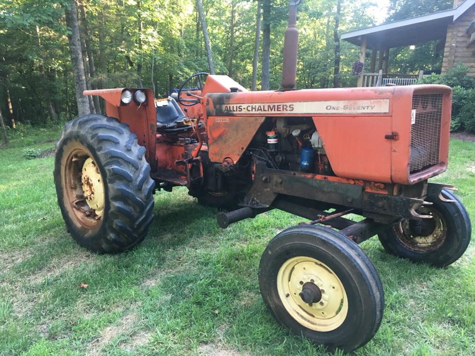

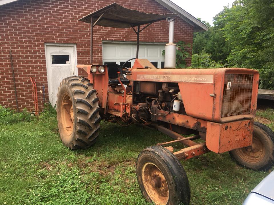

I recently purchased two Allis Chalmers 170 diesels and have a few questions.  First off, what oil do I use to service?  The manual just says SAE-10W, but haven't had any luck finding just 10w without a 30 or 40 after it.  Also what hydraulic oil should I Use?  The manual says Allis 322 with an A for ATF, but is that just Automatic Transmission Fluid?  Same question about Trans Fluid in tractor, what type?  I have a couple of the cylinders that need repacking as well, but thought about just replacing the whole thing. What cylinder measurements will work for exact replacement?  Thanks in advance.
