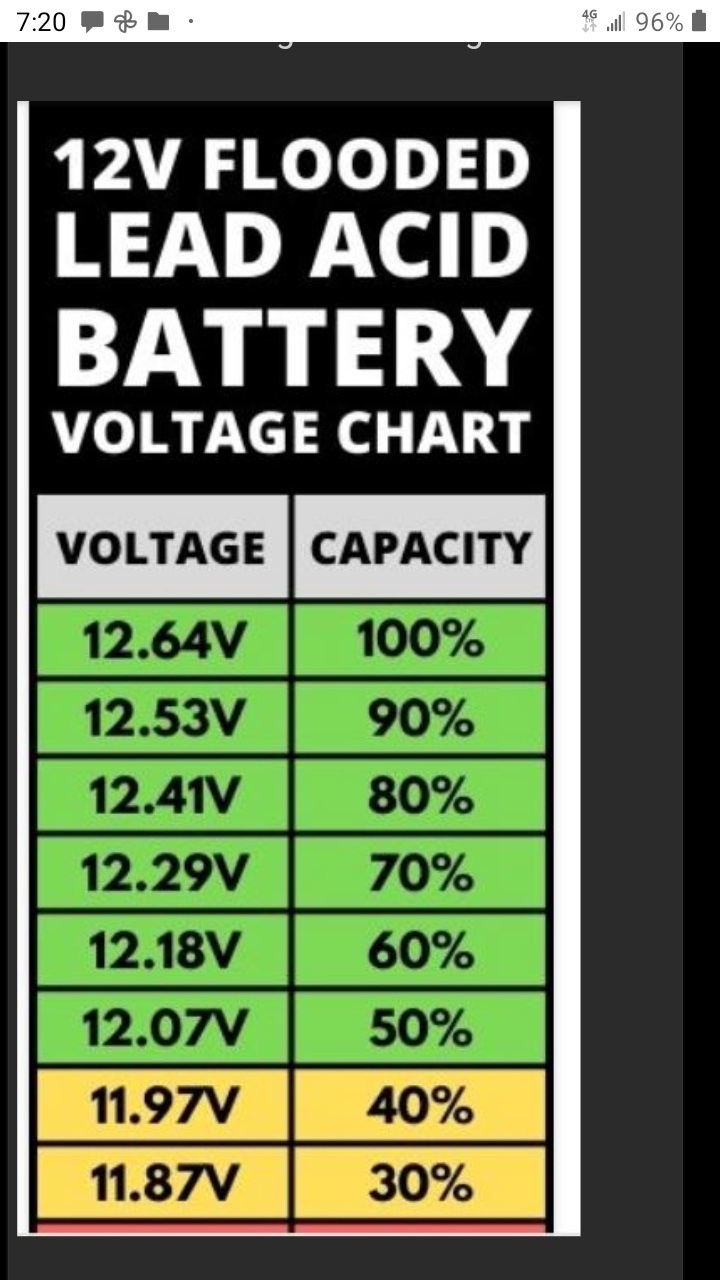

Post Options Post Options   Thanks (0) Thanks(0)   Quote Tracy Martin TN Quote  Post ReplyReply Direct Link To This Post Posted: 01 Jan 2026 at 6:02pm
I charged the battery up. Only shown 11.74 volts on my meter. Hooked it up to tractor, tried starting it, only would buzz the solenoid. Put jumper cables on it from truck, and it started. Pulled the battery out and going to have it checked out. During it running, it showed no charge at ammeter. Unpluged the voltage regulator and re pluged it, still no change. Turned on lights and shows no charge. Voltage regulator is gray in color lid, riveted to base. What couls still be my problem? Any help appreciated. Tracy
Les Kerf View Drop Down
Joined: 08 May 2020
Location: Idaho
Points: 1514
Post Options Post Options   Thanks (0) Thanks(0)   Quote Les Kerf Quote  Post ReplyReply Direct Link To This Post Posted: 01 Jan 2026 at 6:54pm
Originally posted by Tracy Martin TN Tracy Martin TN wrote:
I charged the battery up. Only shown 11.74 volts on my meter...
Is this the same battery that previously measured at 5.34 Volts? If so, it is toast Ouch

Post Options Post Options   Thanks (0) Thanks(0)   Quote plummerscarin Quote  Post ReplyReply Direct Link To This Post Posted: 01 Jan 2026 at 7:21pm
I agree the battery is toast
You know what the voltage is not running. With the tractor running, disregard the gauge on the tractor and take reading with your voltmeter. Should be higher than your static (no pun intended) reading. A load test on the battery may indicate a bad cell
