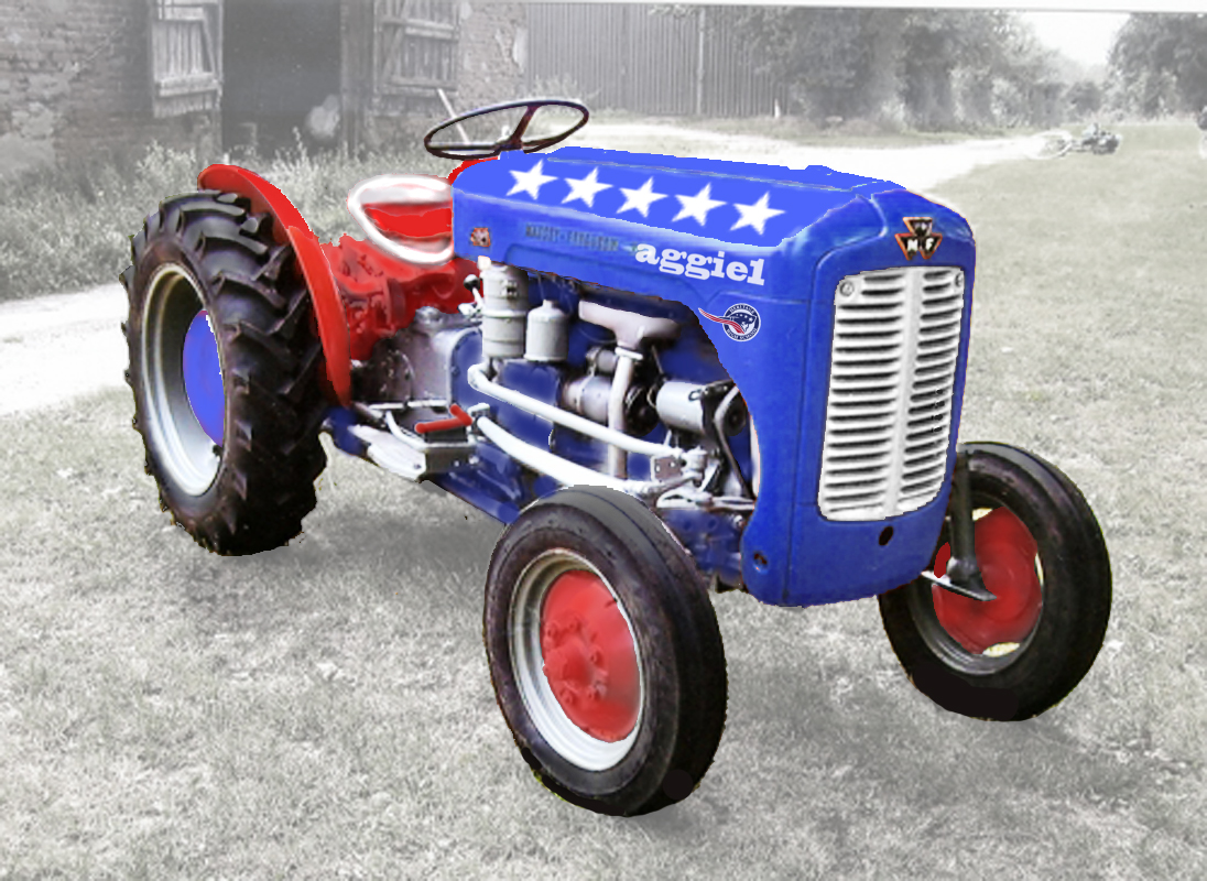

Massey purists may shudder, but here's about what it will look like in its parade clothes.
Heritage HS Patriots school colors are red, white & blue.
(any of my AC's will all keep original colors, however!!!)

Thank you for the Kudo's. After 49 years, I just about know what I'm doin'.  LOL!  Love the Red, White n' Blue!  COOL!  Also, thank you for the kudo's towards the wife. I'm a lucky man to say the least in both respects. She keeps herself in top shape for her age, and she loves Hotrods, Cars, Trucks, n' Tractors. She also drives the wheels off of all of em' to! I haven't figured out yet what she's doin' with a knucklehead like me. LOL! She's a little shy with the posing thing. She'll be test driving this thing shortly. I'm just about done wiring it for the customer. It was a lot of fun doing this project. Something different for a change. Jo Jo's been waitin' about 18 months to bop around in this thing when its done. Just got the engine fired up the other day and set up the new Carburetor. This is one of the original Barris Batmobiles that we were contracted to do. I think there's more wiring in this car than Con Edison in NYC...!  Big smile
