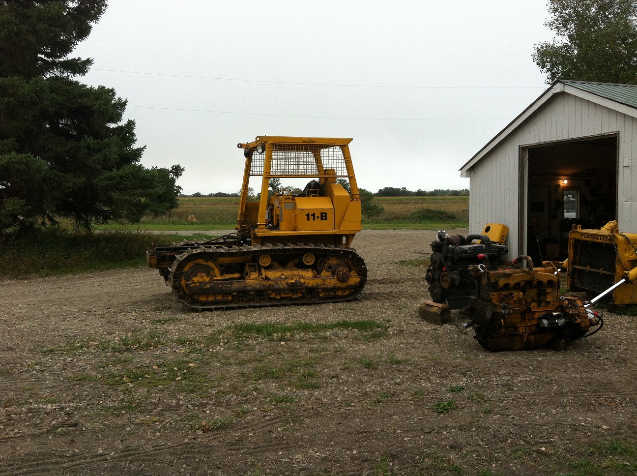

Currently working on fitting an N7 combine engine to an HD11.  Will try to post pics later...

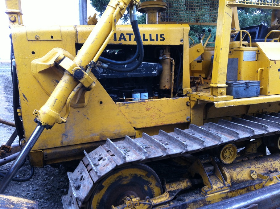

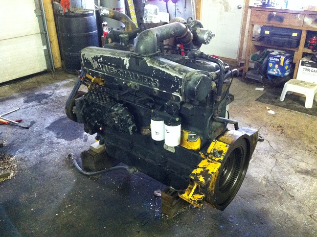

685 engine is inter-cooled, has different oil filters and oil cooler, upgraded injection pump and injectors.  So far I have:
-swapped damper, fan drive and water pump pulley
-installed oil cooler for torque converter
-swapped rear housing and flywheel
-removed electric sensors and plugged holes
I thought this was a good idea because combines in this area are relatively low houred.  This one showed 3500 or so on the meter.  Exhaust manifold is badly cracked though, does not look salvageable, was a common problem on N7 I've heard.
I was going to rebuild the 11000 engine, but a friend of mine knew about this combine, and wanted some parts from it, so I bought the combine, drove it to his place, we pulled the engine, and he bought the rest.

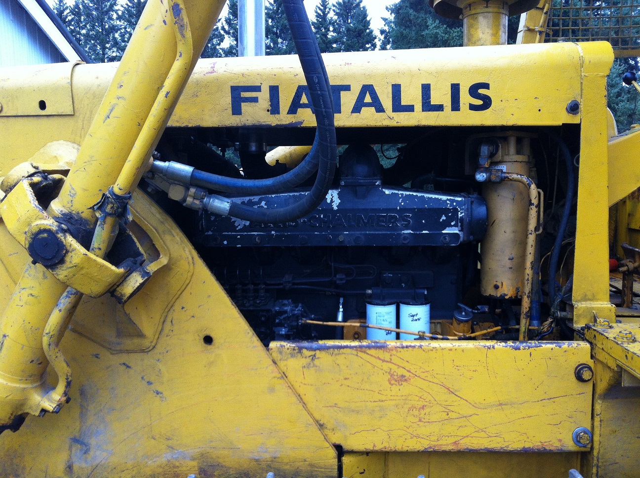

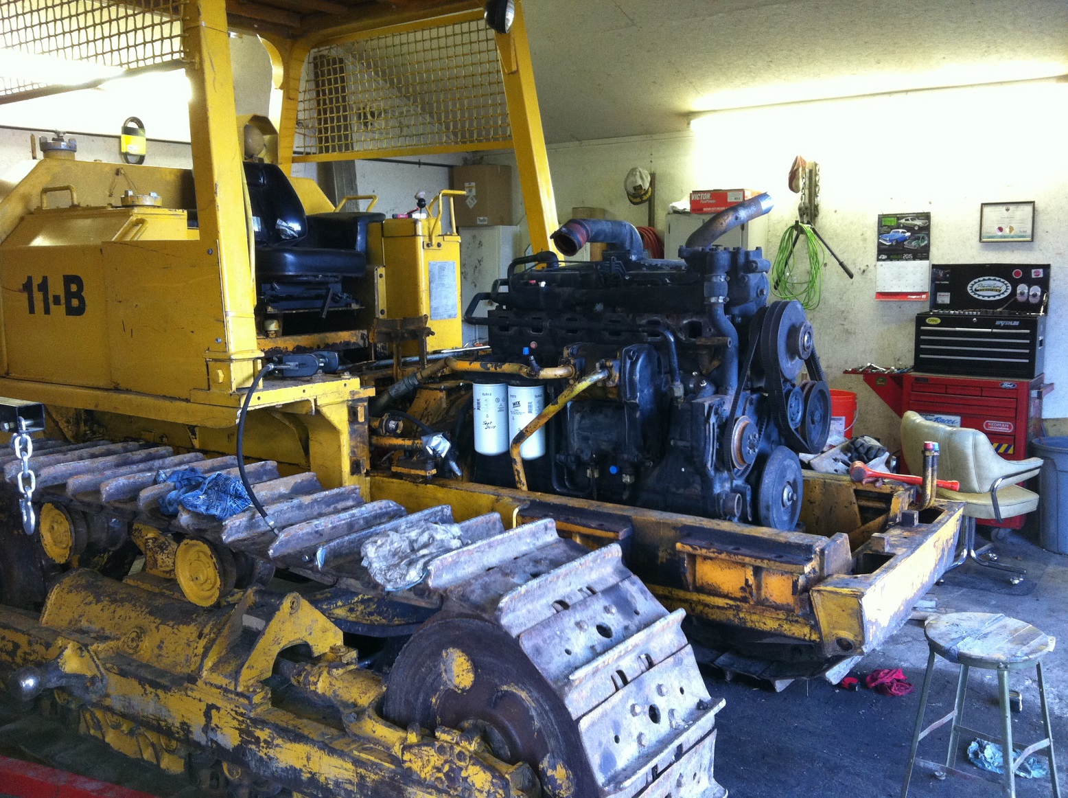

Decided I had better go ahead with oil pump swap- turns out the crankshaft gear is different on the 685, so had to exchange oil pump drive gears as well.  Also had to bend torque converter oil lines to clear spin on filters on engine, and will have to do some rearranging to get the fit between turbo and air filter.  These little things take time.

Tried 'er out today- feels and sounds exactly like any other 11-B.  If you couldn't see the mods, and ran another side by side with it, you wouldn't know which tractor had the 685 and which had the original 11000.  Took longer than I thought, but all in all a success, I think.  Plus it just looks cool.
